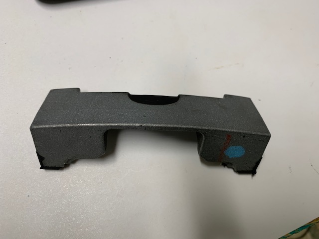

I have a similar noise, but mine is more clanking. I disconnected battery, took off air bag, and there is indeed, a piece of metal that's not attached to anything. Is this your problem? The part is all metal, and weighs about 8 ounces.
Thank you for posting this. Mine just came loose today, must be from the AZ heat. How did you secure it? Epoxy?
