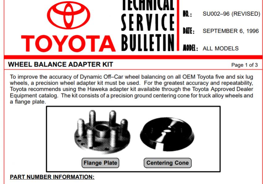

I’ve watch tire guys use the balance machine and often times most of them don’t even know how to use it well. Most of them don’t even know there’s an option to put weights on the inside of the wheel, two locations. Inner and outer on one side. This will give you then best balance.
All Toyota truck wheels need to be balanced with a hub adapter. TSB is attached.

also every time i've brought up the haweka adapter, both dealers/independent shops have looked at me as if i have 3 heads.

I am going to print out that PDF and bring it with me next time.
