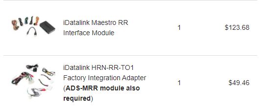

- I actually bought everything from Crutchfield: head unit, module, and adapters (see photo below of module and adapter that i used).
- I had a local shop install it all as they only charged $100. I told the installer that I was not going to be using the talk button on the steering wheel and he was able to add shortcut for me to hold that button to access the tire pressure information. Sorry can't be any more helpful as I didn't do the install myself.
Here is the link to the details on the module.
iDatalink Maestro RR Interface Module Connect a new stereo and retain the steering wheel audio controls and factory amps in select 2006-up vehicles at Crutchfield
