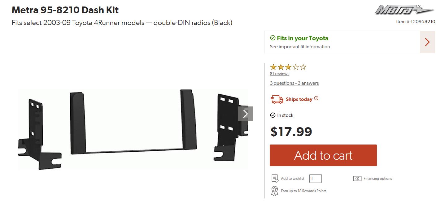

Hey - Quoting a fairly old post, but curious which trim kit this is.
Researching some of the older threads, a lot of the trim kits did not look as sleek.
I believe it was a Metra Dash Kit. It was purchased alongside the stereo from Crutchfield. I recommend you reach out to Crutchfield to ensure the dashkit will work with your aftermarket stereo. Their customer service is typically quite helpful.
