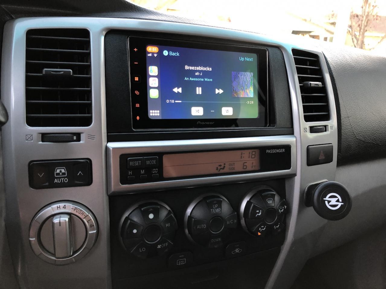

I have the Pioneer MVH-1400NEX (has Apple CarPlay). I love fit and finish. It has the options for reading vehicle status (TPMS, temps, gages, etc) but I didn't end up getting the Maestro. If you paired it with the Maestro, it would be excellent. I have a wireless backup camera that works with it and I also have the JBL Synthesis system and it's working great with the factory amp.
Let me know if you have any specific questions about my setup. Hope this helps.

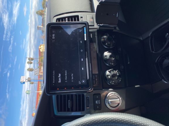

I actually tried the 9" floating model from Pioneer (DMH-WC6600NEX) first, but it felt out of place in the cabin. It also hid other items in the dash, which annoyed the crap out of me. Ended up exchanging it for a smaller Pioneer unit (DMH-W4660NEX)
