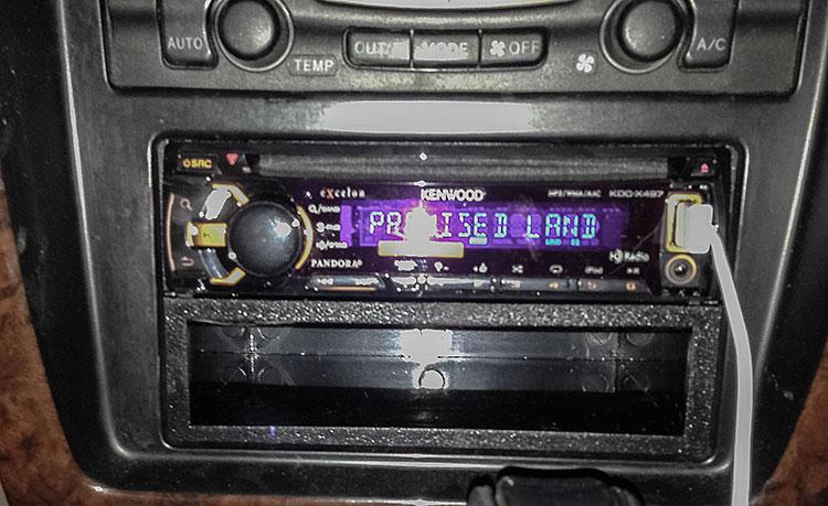

Kenwood arrived this evening. Took me about 1 hour to install. Most of that was splicing wires. Console came apart and went together in minutes.
it was tricky trying to determine how to deal with the amp but Crutchfield has reps on the phone till midnight EST and a quick call set me straight.

Aw heck...it's pretty dark outside but here's a glimpse. Way too much dust and out of focus but should illustrate what an ape with a screw driver can accomplish with the proper direction.
1st radio install I have done in the modern era without breaking something....
Thanks again and I'll post better images of the entire 4Runner soon. I pretty much finished a baseline of everything and it's running fantastic! Feels like 2x the HP from when I bought it. With the stereo cranked up on a shakedown cruise I could not hear the motor or anything beside the Dead and got to feel the ride and response without audio feedback; road noise etc... I was able to feel the 4Runner and not worry about extraneous noise. Cool!
