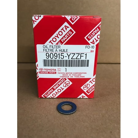

Which filter are you referring too?
I have several 90915-YZZD3 filters for my V8 but I think the V6 uses the same filter and yes they are sealed with a plastic film on the opened end...but none of them have a new drain plug washer in the boxes, when you posted this I went and looked at all of them, they were bought from a Toyota dealership so I know they're genuine OEM filters.
Edit: I just looked online and a very few vendors especially on eBay selling the cases of filters do include new drain plug washers, but most do not, when included they seem to come in a separate plastic bag package and not in the individual filter boxes.
I believe that is the same filter for both motors but don't have the PN on hand. So far, I have gone through at least a dozen, and the last case I bought (in-store at the dealer) had a new blue gasket washer in the bottom of each of the filter boxes.
I just toss them though since I have a fumoto valve and don't need to remove anything.
typically looks like this (but different PN)
Toyota filters.
