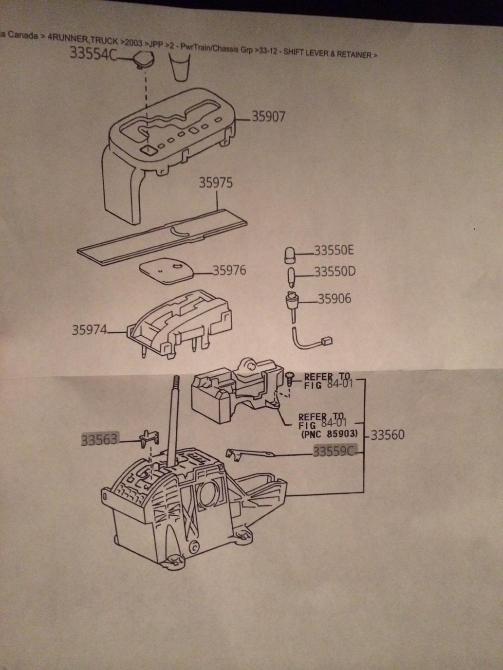

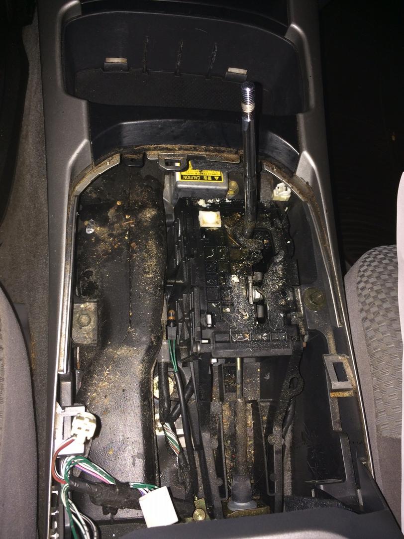

First pic shows the black plastic shifter box with most of the centre console removed (clearly in need of a good cleaning) and the second pic is the parts diagram from Toyota.

Hokie Runner, thank you for the link. The problem I'm having is the same as the one discussed in that thread. The fix is simple, but unfortunately very expensive. Toyota won't sell the little plastic part that is prone to breakage, so you you have to buy the entire shifter box, which is over $1,000.

I had the same issue on my shifter. I was able to fix mine by cutting the spring under the metal pin that rides into the shifter locations, and placing the rod back into the slot.
Mine was floppy before the fix. I know there is white grease in and around the spring and the metal guide pin as well as the guide itself. It might be worth it to try and re grease that area.
I do not know if I got lucky but I think the reduced pressure from the spring allows mine to catch just enough with out it grabbing and pulling it out.

I think many factors go into the "sticky" shifter. While I had mine apart I noticed a few things.
1. There was a lot of grime, dirt, sticky stuff that fell down and into the shifter area.
2. The white grease in the shifter track and spring area was dry and or gone, that's to be expected over 14 years. Mine is a 2003.
3. Speaking of my driving I never really shifted past D/4. Because of that, the track was much more worn only in the common shift points.
4. Years of the pin being slightly pushed and pulled causes the plastic to fatigue. Which causes a small crack around the hole the pin and spring sit in.
I think a good cleaning of the the track, reapply grease to pin, track, and spring as well as shifting through all the gears more often would be the best maintenance. If it still feels sticky cutting the spring down to release a little tension also will help. Mine was floppy and I was able to fix it doing the above.
