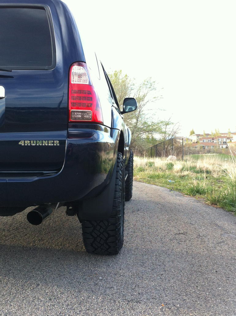

I got the FJ wheels and I'm also using 1.25 spacers The 06-09 can take .5 more than the previous 03+. With the 2.5 lift 265/70 or 255/75 is about it. a 275/70 will be a little big I think. I found the rear easy to deal with the front requires a bit more work.
This pic gives you a idea of 285's 2012 tt FJ wheels with 1.25 on a 06.
Sold my spacers and went fj. They're a better offset and less rubbing than sport wheels and spacers.
