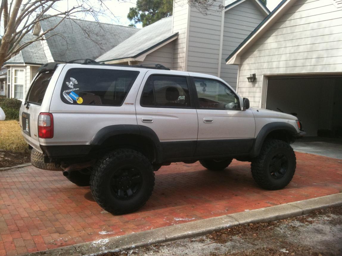

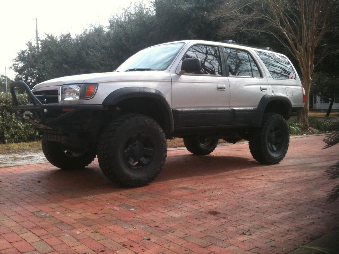

97' Limited
Toytec Ultimate/1.5" spacers in rear
Kumho Road Venture M/T
285/75-16
39" front-40"rear
Had the lift for 4 months now, which is another important piece to add due to the settling of the springs.
I love the lift and tires, she's a beast!:bravo:
Next will be 35's and 5.29 gears

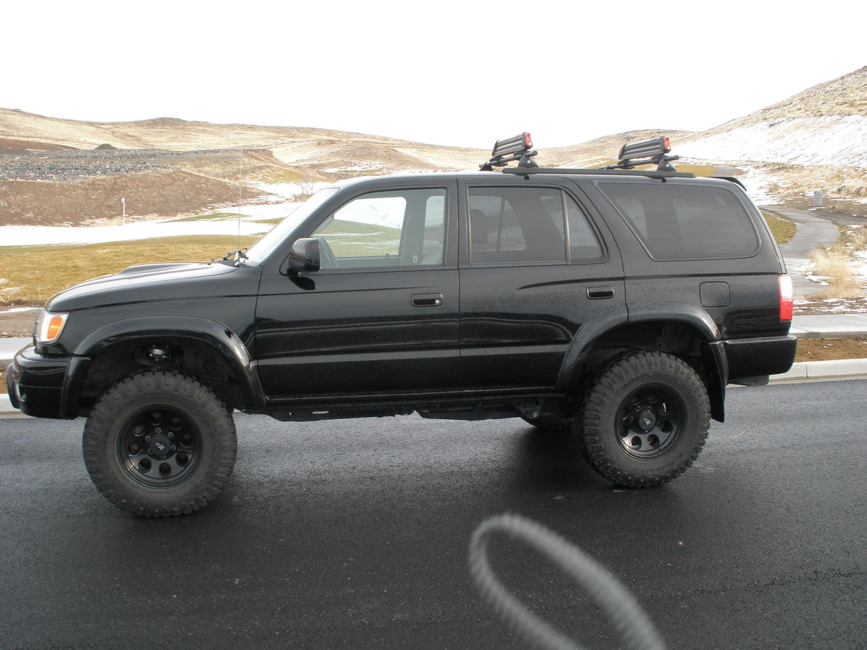

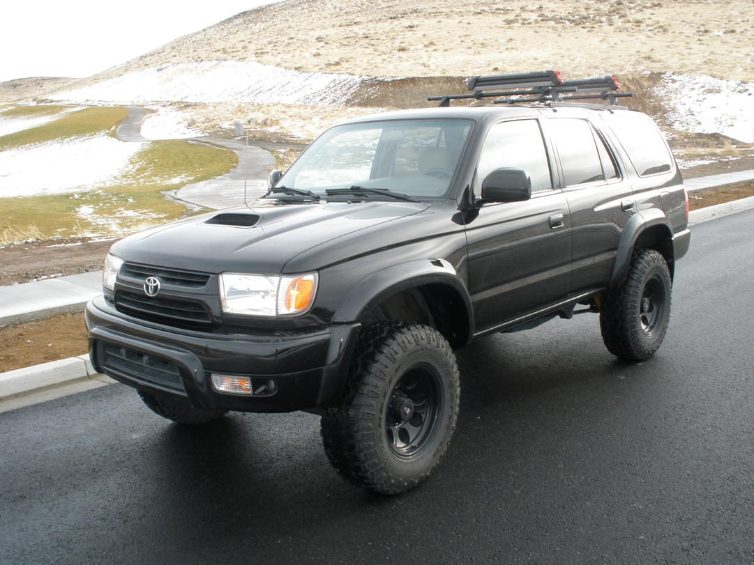

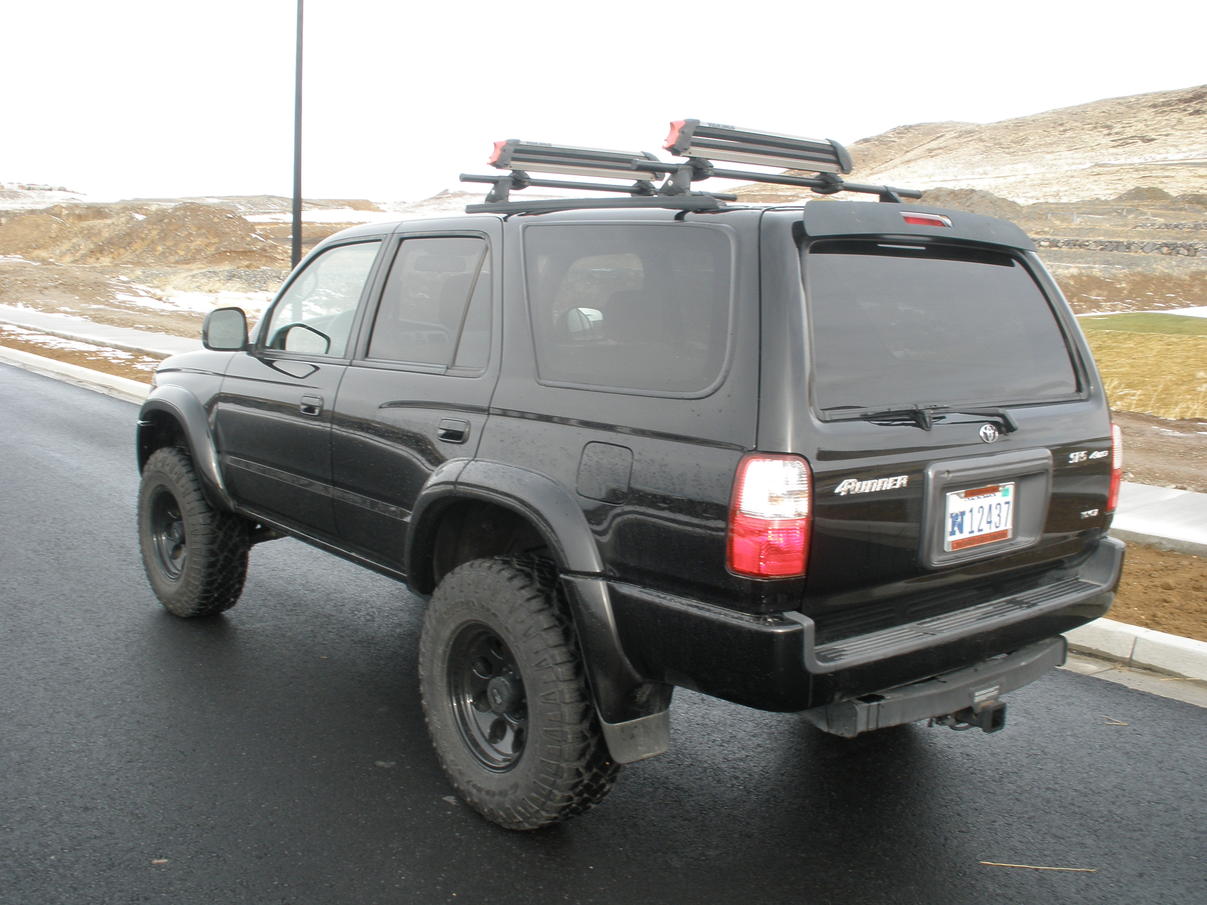

Finally took some pics
Hepar here are some pics

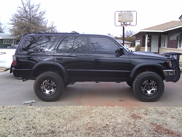

1999 SR5 4x4
lift front - 2.5" skyjacker block lift
lift back - 3.5" skyjacker block lift, OME 891
front fender height - 38"
rear fender height - 39 1/3"
tire size - 33" 12.5/17
tire - cooper discover S/T
Thorrider- Do you have spacers to run the 12.5 up front or did those bada$$ wheels take care of it? Looks good.
umm i have 2.5" lift up front but when i turn they touch a lil but they are -12mm offset rims so they stick out enough
if thats what you were asking
Wheel spacers, I had to use 1.25" hubcentric spacers to keep the inside of the 285's from rubbing the upper control arm.
nothing like that, bought the rims for the tires to fit the truck with the right offset, its just basicly built in the rim is all
