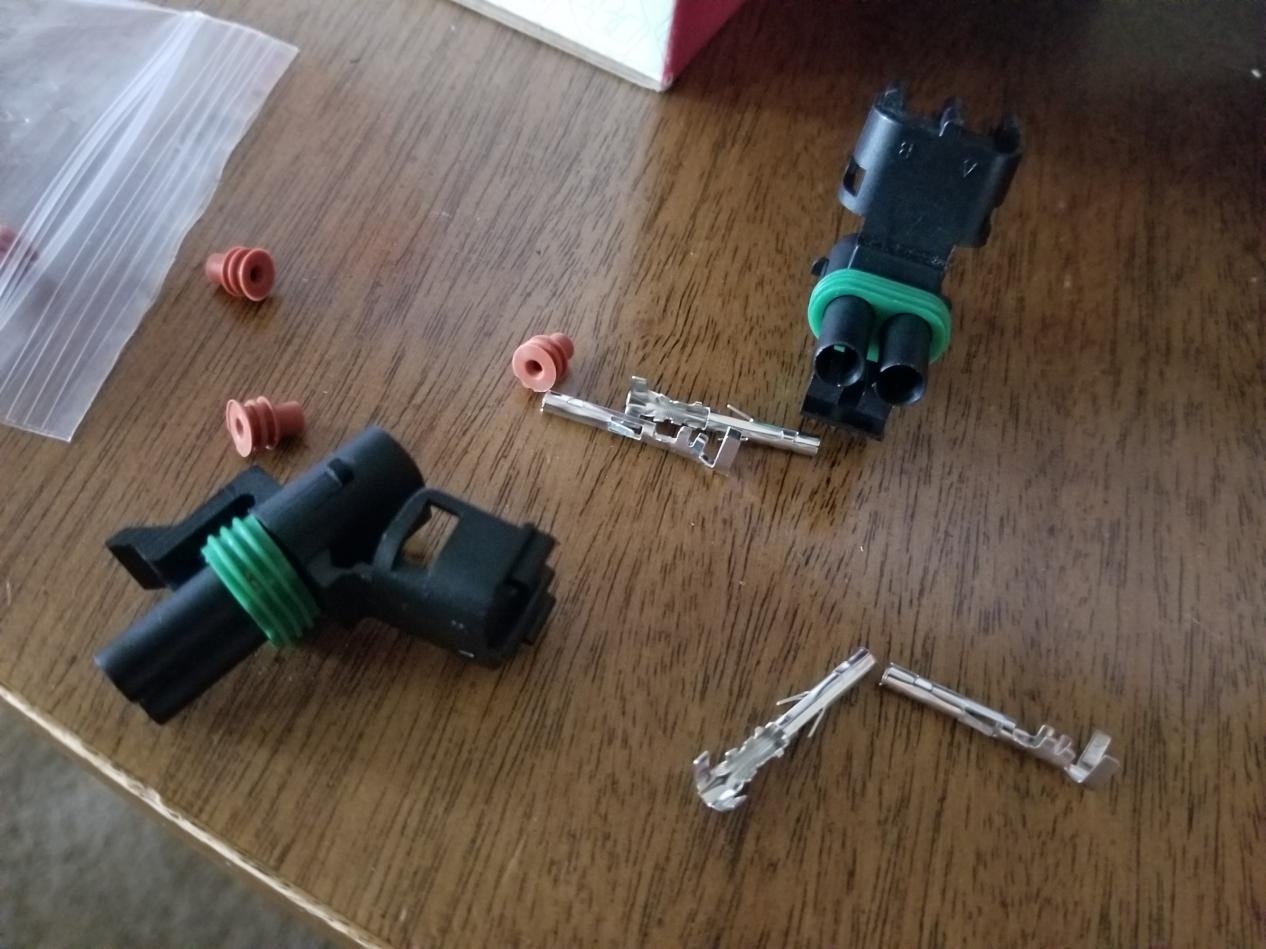

I recently acquired some Baja Designs squadron pros. I am planning on sticking them in my bumper and want to wire them into the stock foglight wiring. Obviously the connectors off the BD lights won't work with the Toyota plug. I saw BD offers a plug and play kit for the newer 4runners. It is for an H11 connector according to them. Does anyone know if that adapter would work with the 4th gens as well? My searching has brought me no results.
I just cut my OEM connector off and spliced in a weatherpak connector. The lights come with them as part of the harness I believe.
Edit: This connector is what I’m talking about.

The kit I bought (with the fog light bracket and wire adapter) was for a Tacoma and I think 5th gen too).
Only change you have to make is reverse the polarity of the two wires and it all works.
I called BD's customer service, explained that I wanted to plug my squadrons directly into my fog light connectors but didn't need a bracket kit and they shipped me just the connectors for like $20.
Thanks for the replies guys, I might give them a call tomorrow to get those adapters on the way... not too fond of cutting my wires.
If I do cut them [MENTION=109843]montijo505[/MENTION] are these the connectors you are talking about? Easy as cutting and crimping?
Yes exactly! Took two minutes
