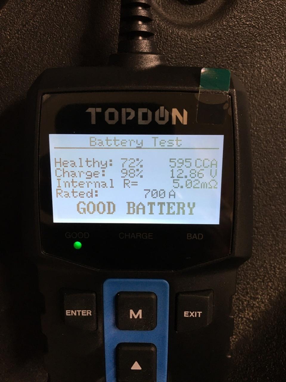

I posted about battery testers awhile back...
I just bought a Topdon battery tester, I’m not sure how accurate it is but it seems to be consistent with what most of us are saying here about expected lifespan of today’s replacement flooded battery options available . It rated my 6 year old RAV4 battery as needs replacing at about 50% health and CCA. Rated my 3 year old Costco battery at 72% 595/700 CCA.
