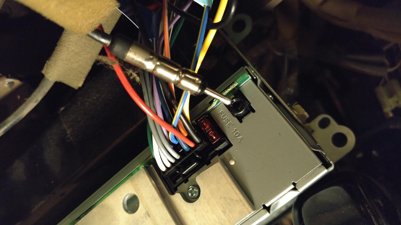

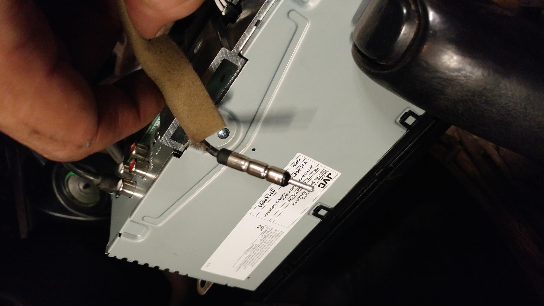

Back again. So I successfully installed new front speaker's, tweeters and head unit. Speakers were a breeze. But I had one problem with the head unit.
When I unplugged the stock radio, there was a power cable, the harness plug and one other small silver plug. It was plugged in directly next too the power cable.
On my new head unit, there is no socket this fits into properly. On the new head unit it almost fits into the socket next to the writing "fuse 10a" but it's way too loose and drops out. I hooked everything else up, and it's working just fine. Anyone know what the plug is? Where does it go? Should I be worried?

That's an extra antenna cable. There's an extra antenna in the a-pillar that works if the main antenna is down/broken.
Nothing to worry about. Not really necessary unless you custom wire a toggle switch for the power antenna.

Aha! Great news. Thanks for the confirmation. Very successful day.
