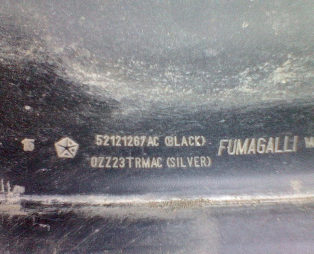

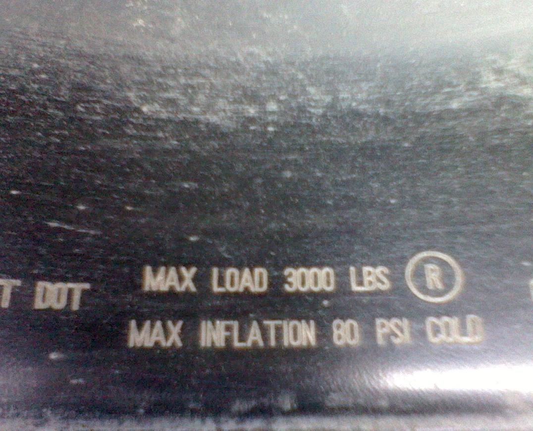

I don't think I misspoke.I know Split rims like some trailer wheels have max pressure ratings. One piece and alloy and steel don't that I know of. Bending forces yes. If you have some documentation though I would love to see it. I will make a few calls tomorrow.
after a bit more reading, it seems as tho they also are sometimes stamped inside the air chamber. so the tire would have to be dismounted to see it.
I looked, but couldn't find anything solid. just hearsay.
but, I do know that when I was busting tires for a living, that I did in fact see pressure ratings stamped on wheels. 65psi comes to mind. but I was unable to even find a picture showing that.
just to confirm this.
these are from a 2015 dodge 3500. from a few months ago. I forgot they were on my phone.
I knew I wasn't crazy, and had seen wheels rated before also.

If this can handle 140psi - I think a typical OEM wheel is just fine at 80psi. But it is an interesting question.

You're right.
Back in the day, when I worked on consumer vehicles, I also saw plenty of wheels that were marked with a maximum PSI rating for the wheel itself.
Back before TPMS sensors became common place, rubber valve stems also had a maximum PSI rating. They still do, for older vehicles without TPMS sensors.

Any wheel can fracture and/or explode under pressure, just to get that out there. My whole point was "reasonably." Will it fracture or explode before the tire does? No way, unless, as I said before, the two piece split rims or the old two piece welded rims. Also depends on the rim construction, material, damages, etc. Don't worry about the rim before you worry about the tire is the point.
[MENTION=118321]Jetboy[/MENTION], sure those bike rims will handle 140 psi. One big reason it there is a lot less "i's" to square even with a lot of "p's" lol compared to a big truck rim.
