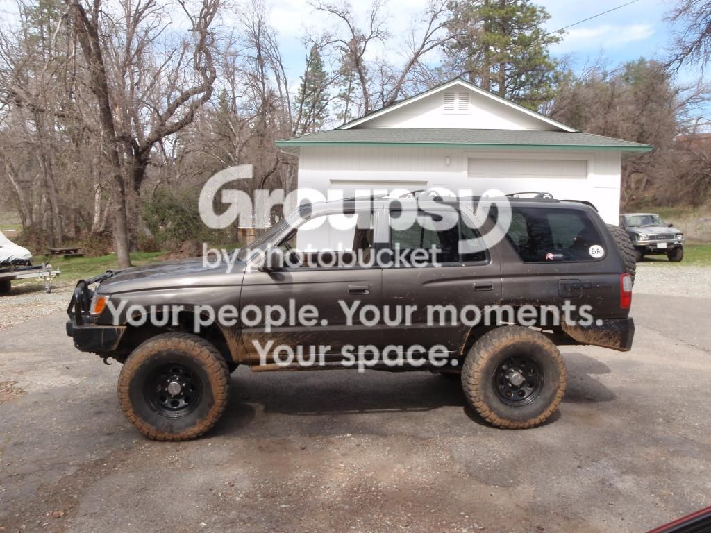

The 861's are in. I've driven about 10 miles on them, but I can tell I'm going to like them a lot.

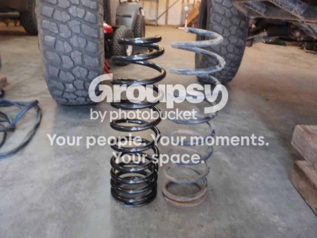

OME 861 and old LC 9 wrap side by side

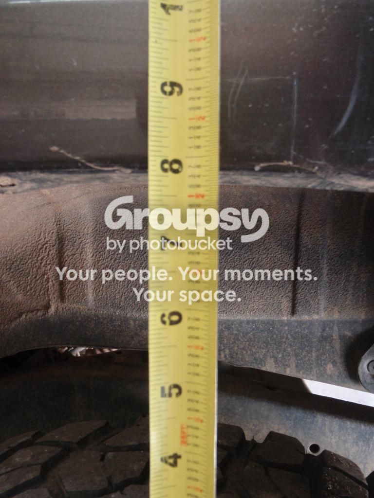

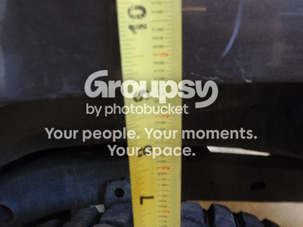

Before
After

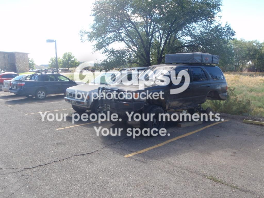

It's got a bit of rake, but the new shock bushings for the front should be here soon to replace the old blown out ones. That should give me another 1/2 inch or so in the front. I don't mind a bit of rake though, and it will be just about perfect with the tent on top and the full jerry cans on the back.
A few things to compare the 861's to the 9 wraps:
- First of all, I immediately noticed the rear end is much stiffer now. The 9 wraps made the rear end float around and bounce on bumps on the highway, that has been eliminated. The 861's absorb the bumps much better, and I don't get the floating feel anymore.
- I run no swaybars. I've always had quite a bit of body roll, but that has been reduced quite a bit. The whole rig seems to hug the road better now. With that being said, I've never been able to get a rear wheel off the ground on a sharp turn with the 9 wraps. Today I did it with the 861's, it was a bit scary and I wasn't expecting that lol. I guess since the new coils are much stiffer than the 9 wraps, the rig can't lean as much without pulling the axle with it. Now that I know what to expect, it wont be a problem.
-The 861's flex great, just like the 9 wraps. But I already knew that, thanks to the handful of you that run these coils and have talked about their wheeling ability. So thanks for that!
I'm really looking forward to loading these coils down with all my gear for the Overland Expo trip in less than a month, that will be the real test.

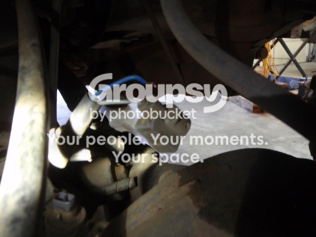

...In other news, my elocker is giving me problems again. I switched it on to help flex out the 861's, and I couldnt get it to switch off. I had to pull the actuator yet again and turn it off manually. When I was down there I found this broken wire
This is definitely not a good thing, but I'm pretty sure this connector only controls the lock sensor, and not the motor itself? This is the small connector BTW. I'll try to figure it out on my next day off, whenever that might be.

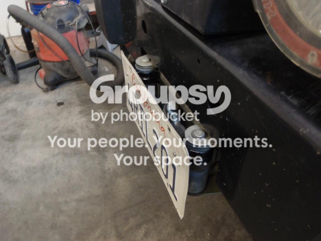

I'm back in California now, and just got picked up by California Highway Patrol. I leave for the academy up in Sacramento in March.

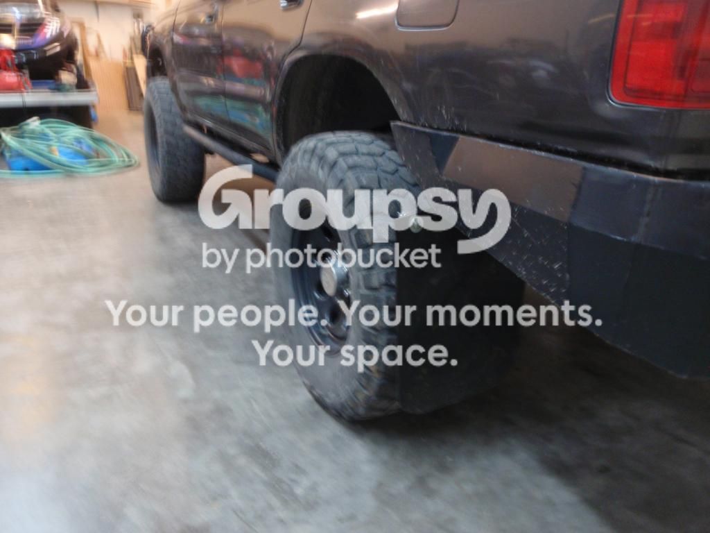

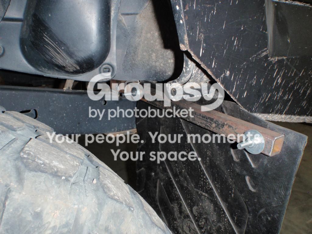

In order for me to have the 4runner at the academy, it has to be perfectly legal. Cadets walk around the parking lots and look for violations, and write real tickets if they see any.
So for the mud flap problem, I came up with this. Looks like hell, but at least it's legal. Welded a small length of square tubing to the top of the frame rails with a hole drilled in them, and secure the mud flaps with a bolt and wing nut for easy quick disconnect. These will pretty much be used at the academy only, and as soon as I leave that parking lot they come off.
And did the MagLight clip mod for the front license plate on the winch fairlead, so now I'm legal there too.

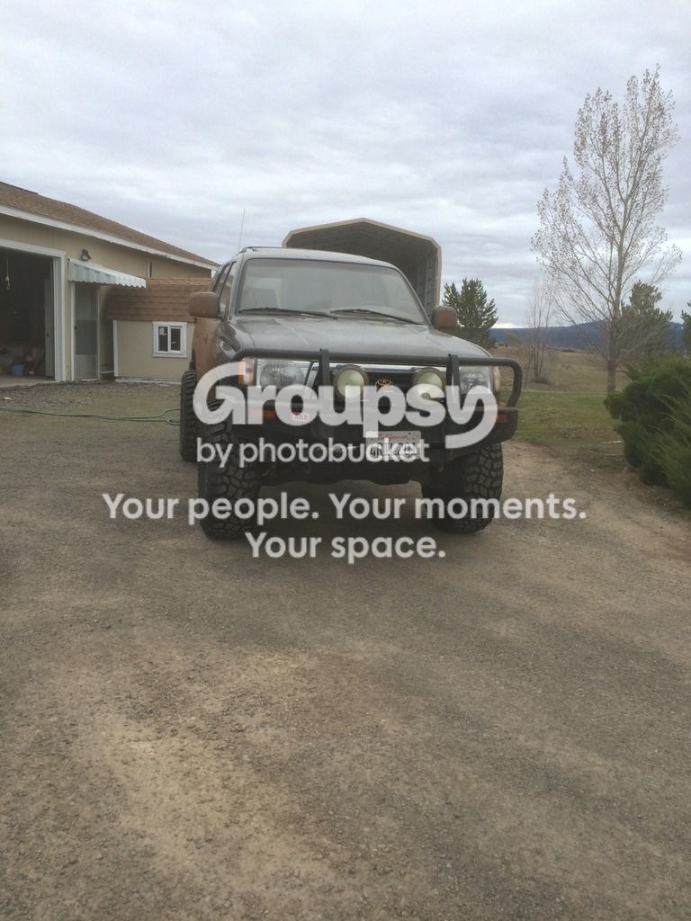

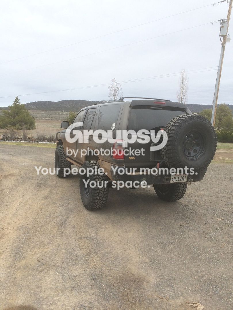

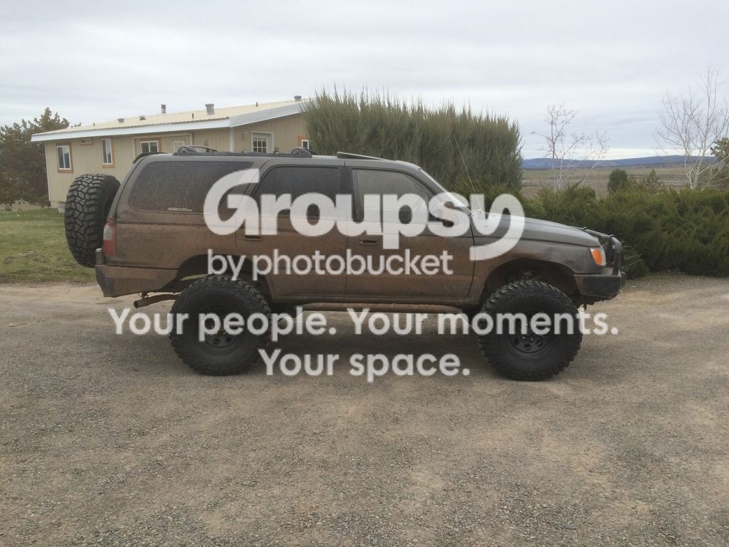

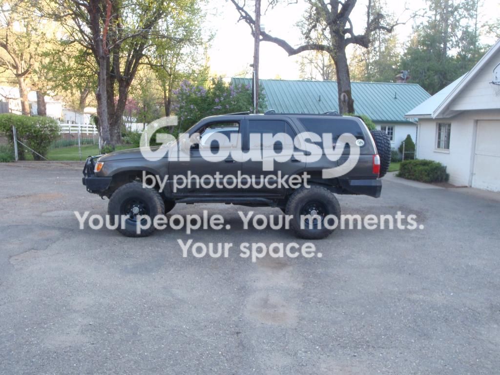

I haven't been on here in quite some time, but I'm finally getting back to putting work into this thing now that I have the time.
I figured 315's were long overdue, so I got me 5 new 315/75/16 Cooper STT Pro's. Had to do a bit of grinding and pounding on the pinch weld, and had to get some 1" spacers to keep them from rubbing on the spindle. But they seem quieter on the highway than the KM2's and have better siping, which should be nice for all the snow and ice we get up here. I think I'll be happy with them.
I've got an ARB fridge on the way, and I'm in the process of piecing together everything I need for a dual battery setup. I'm going to get power to the roof also and add some LED lighting to the tent. Hoping to have all this done before I do a Moab trip in May.
Here's some pics of how the tires look.

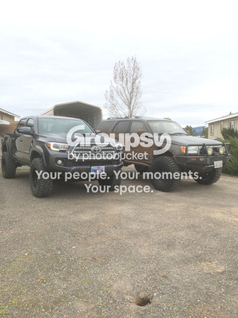

Before this, I've been focusing on getting my DD set up the way I wanted. Here's the finished product. Ain't she purdy??

Your Tacoma isn't too shabby either, congrats on the purchase.
