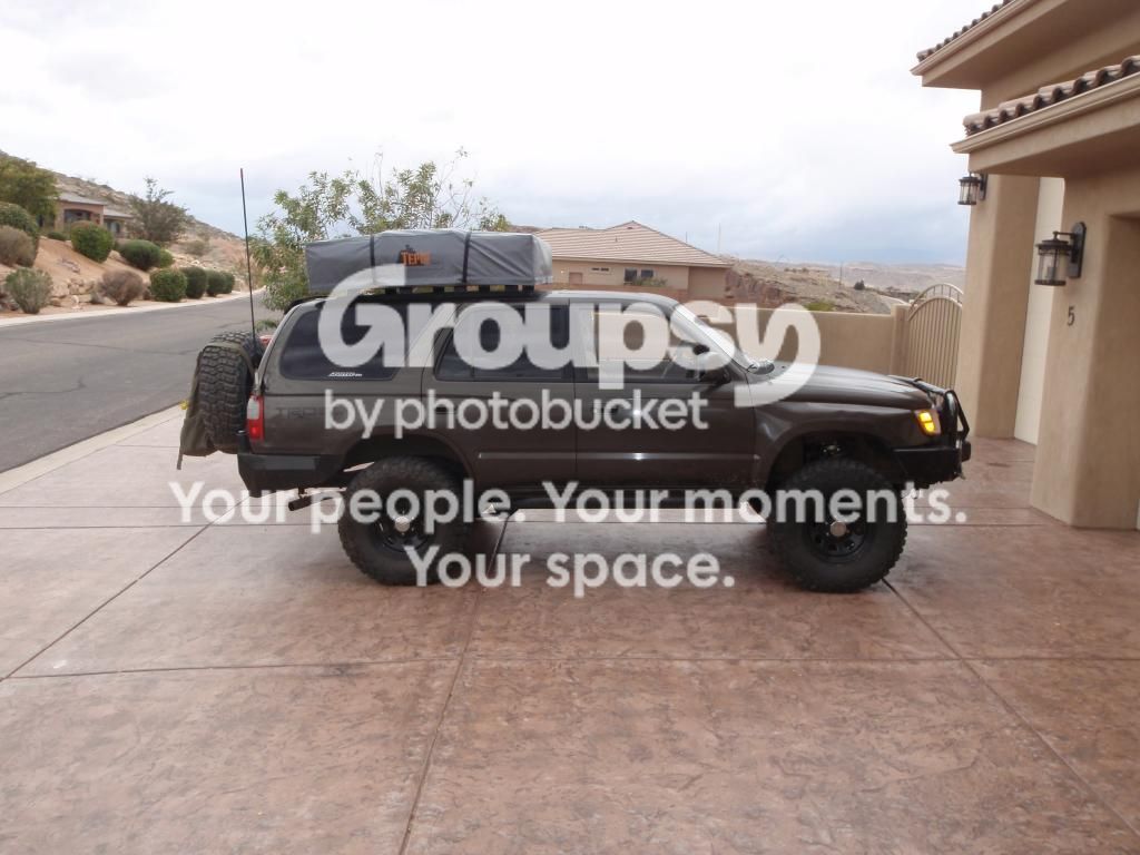

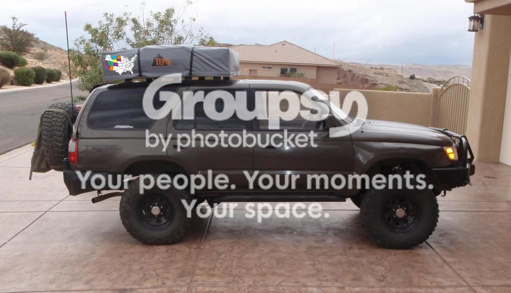

Here is a crappy idea of what it would look like.
PB080682A_zpsf47c4d0c.jpg~original
Maybe it would look better if it wasn't a solid sticker, and only the outlines of the states. That way there wouldn't be a solid white mass of all the states I haven't been to.

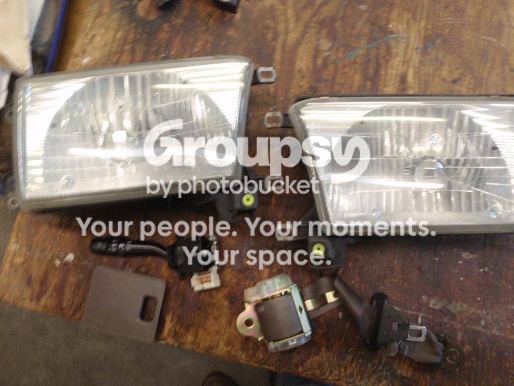

Picked up some goodies from a partout today. Will all be going in within the next few days.
P3151138_zps53234ef3.jpg~original
And the tent will be going back on soon for summer. Figured out my states sticker and will be ordering that soon. Not sure where on the tent it's going yet, but it will look like this.
PB080682A_zps49f015a1.jpg~original

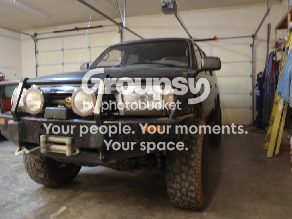

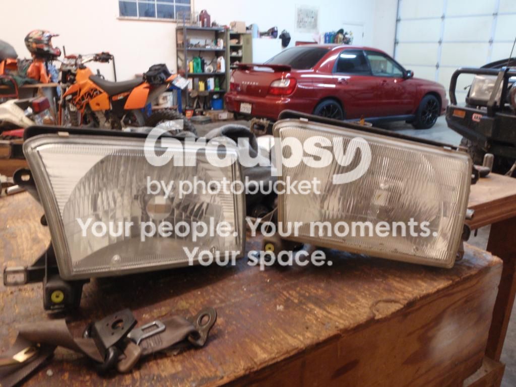

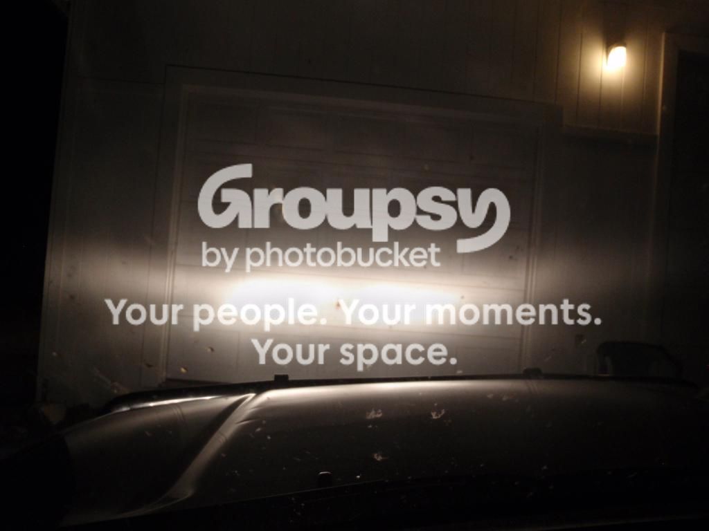

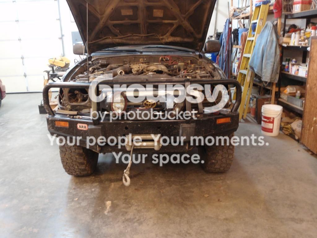

Lights are in. Took me all of 1 hour.
97 and 99 side by side
P3151149_zps9b8c2798.jpg~original
During
P3151151_zpse97965f5.jpg~original
After
P3151155_zpsac320907.jpg~original

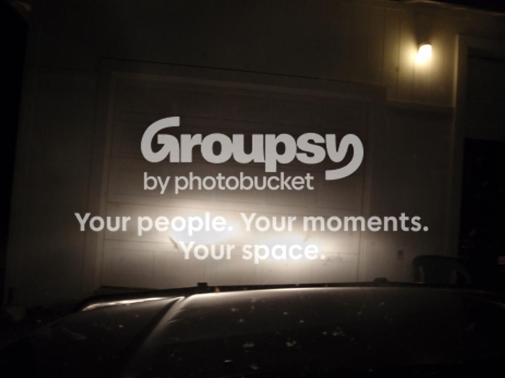

Light output before
P3151136_zps839a145d.jpg~original
Light output after
P3151152_zps63ca7a23.jpg~original
Overall, the light output is a little better off to the sides than the old ones, but other than that not much improvement. Was to be expected though. They look ok, just didn't wow me with looks like I kinda expected. Oh well, I'll keep the old lights for now in case I get an itch for another mod and need a quick 100 bucks lol.

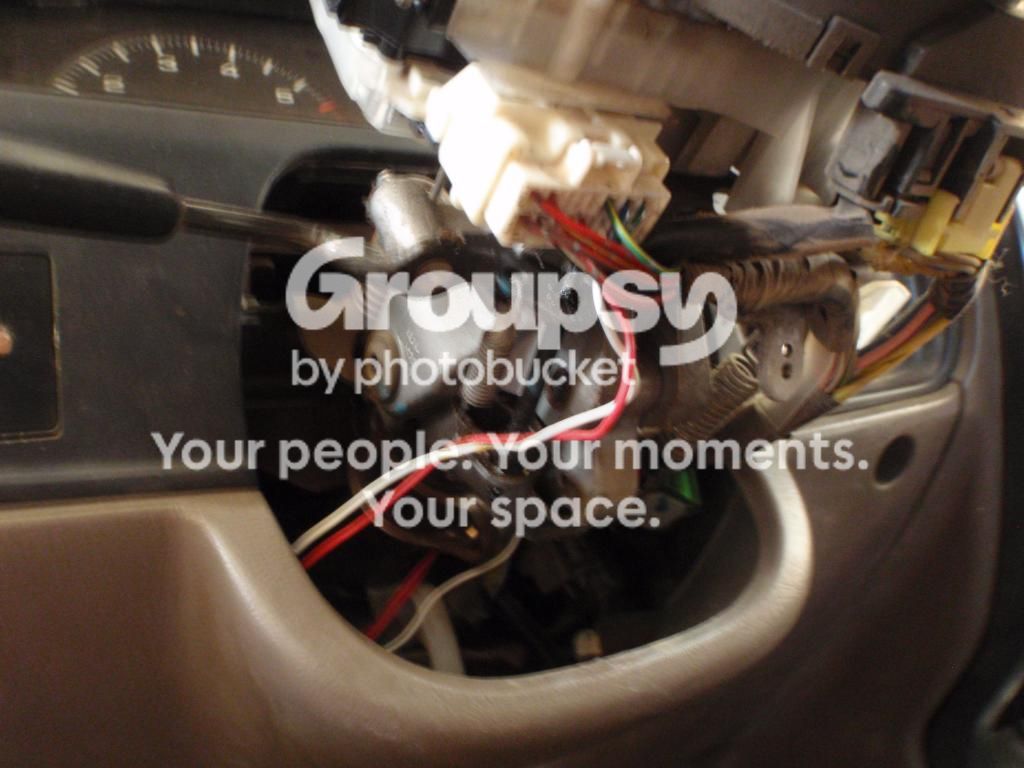

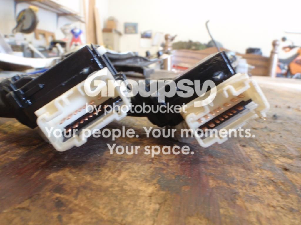

Got my HID offroad lights wired up to my new headlight/foglight combo switch from the 99 partout.
The reason for this is to save value switch space on my dash. I'm planning on getting an ARB front locker and compressor down the road, as well as an LED lighbar or two. I don't have the space for all those switches on my dash to the left of the steering wheel, so this is an easy way to save up some switch room. Since I don't have factory foglights, it is easy to just wire up my offroad lights to this factory foglight switch on the column.
This was super easy to do, since the combo switches from both my 97 and the 99 had the same plug for the wiring harness. The only difference was my old 97 harness was missing 2 pins in the plug for the lights.
P3171168_zps00b0fed3.jpg~original
P3171169_zpsc2e2c5d9.jpg~original
All I had to do was look at the pins in the 99 harness, then compare it to the pins in the 97. The 97 had 2 less pins in the harness, so I knew these were for the pins for the positive and negative for the light switch. Here are the two empty pins on the 97 switch harness that need to have wires connected in order for the lights to work. The larger pin is positive, the smaller is negative.
P3171170_zps87f60e56.jpg~original
All wired up, installed and one less dash switch to worry about!
P3171171_zps67fca1af.jpg~original

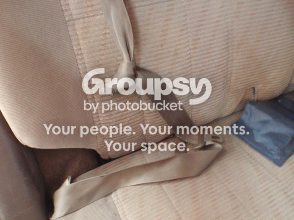

Also fixed my rear seatbelt. It stopped retracting years ago, so as a solution I just tied it in a knot to fit about a person my size. This meant you were buckled in, but couldn't move at all. My friends won't be fighting over who has to sit in the rear passenger seat anymore!
This is what I was dealing with for 3 years...
P3171172_zps9a579ed3.jpg~original
