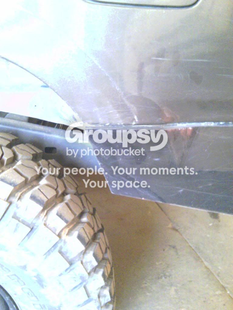

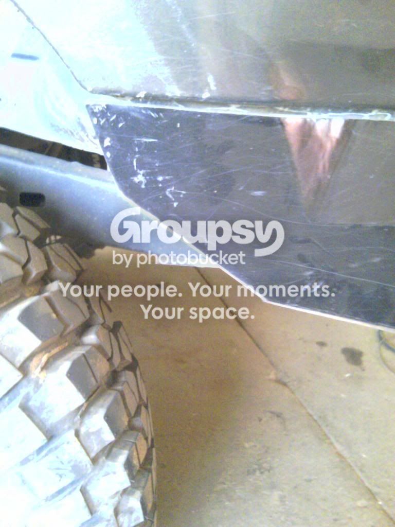

Had the first big wheeling trip since the new tires yesterday, and I had one big problem. The way my rear bumper was made wouldn't allow my new tires to stuff without hitting the bumper and digging into my tread. When the bumper was made, I had semi bald 33's and it wasn't a problem then. I didn't forsee that it would be a problem with larger tires. Today I plasma cutted parts of the sides off to clear 33's when stuffing, as well as 35's if I get them later down the road.
Before

After

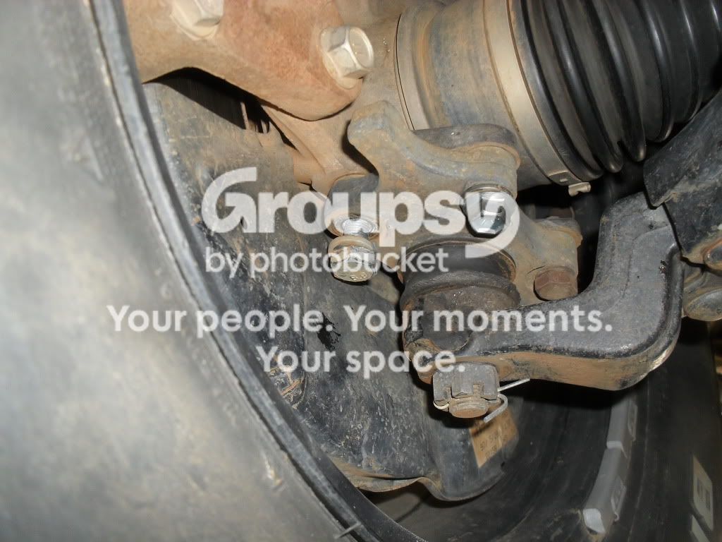

Replaced the lower ball joint bolts yesterday. Ever since the last Pismo trip I had to replace them with cheap Ace Hardware bolts because most of my other ones had fallen out on the dunes for some reason, guess I didn't use enough Locktite on them. I got some new factory bolts because I was worried about the old bolts not holding up if I head to the dunes again
New factory bolt on the right, cheap Ace Hardware bolt on the left. Plenty of Locktite this time.

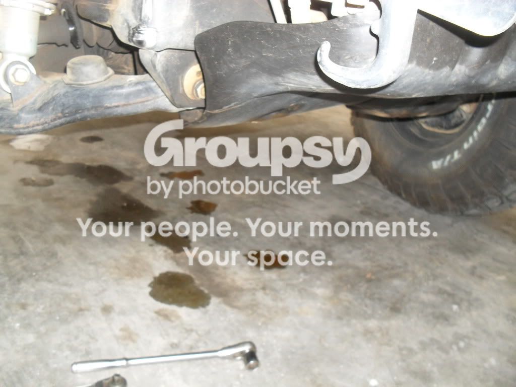

The 4runner is due for a bunch of maintenance. Still havent replaced my leaky oil pan, need new valve cover gaskets, new cv's and new lower A arm bushings. Tired of the floor of the shop looking like this
