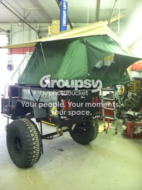

And a couple pictures.
83adf052.jpg~original
a215f236.jpg~original

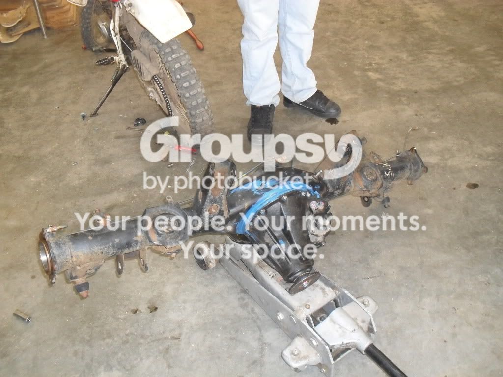

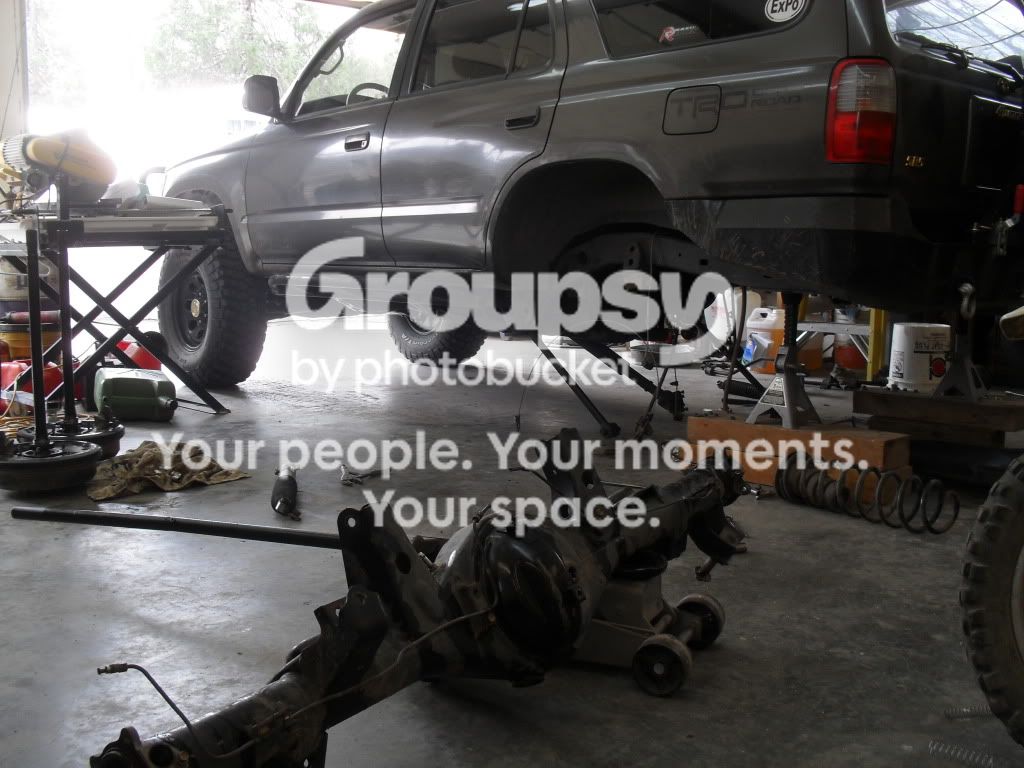

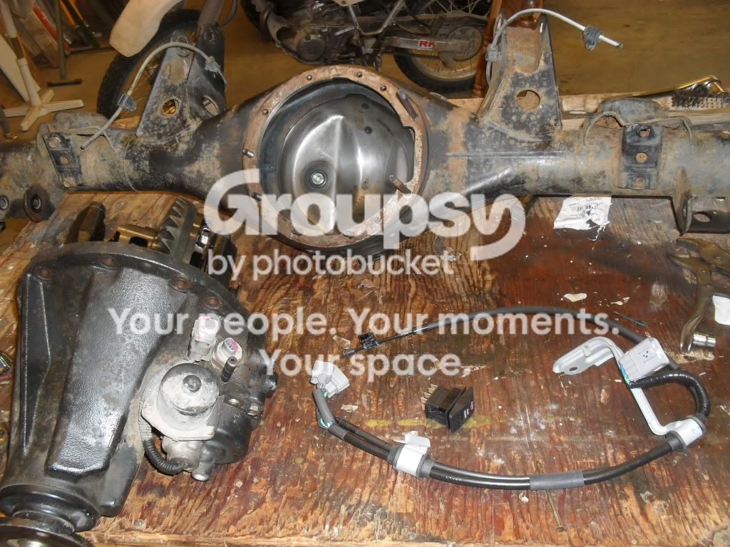

Locker is in! It was a ***** to throw in, but a good learning experience I guess. Everything seemed to be bent or tweaked in one way or another, so taking off the old axle and putting on the new one was more of a pain than it should have been.

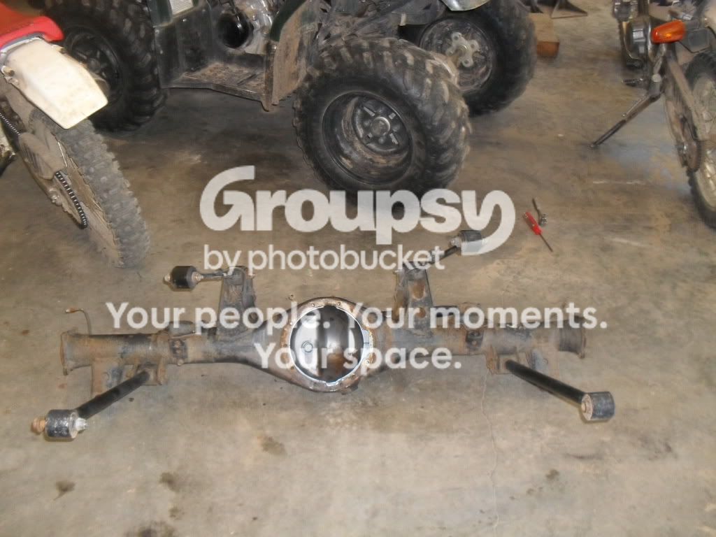

Here's what I started with
SDC10441.jpg~original

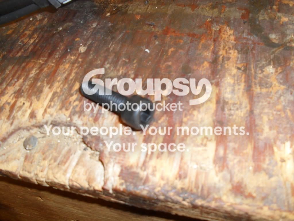

I swapped all the axle studs with button head allen bolts. I've heard of peoples diffs actually pulling out from the housing under high stress, so these will prevent that from happening.
SDC10442.jpg~original
SDC10443.jpg~original
All torn down, pretty much wore out by this point lol
SDC10448.jpg~original
The new setup. Don't mind the crapload of RTV...shortly after sealing up the diff, I realized I forgot to put the oil deflectors back in the axle. So I had to open the whole thing up again and put even more RTV on. It was a blue nightmare. And yes, it's not as beautiful as BigFishAllDay's axle, but hopefully it will be someday!
SDC10450.jpg~original
Eventually my brother wandered out of the house to help me out. Then friends started showing up randomly. They stood around with beers in their hands for a while, then they eventually helped reassemble everything, which I am really thankful for.
SDC10452.jpg~original

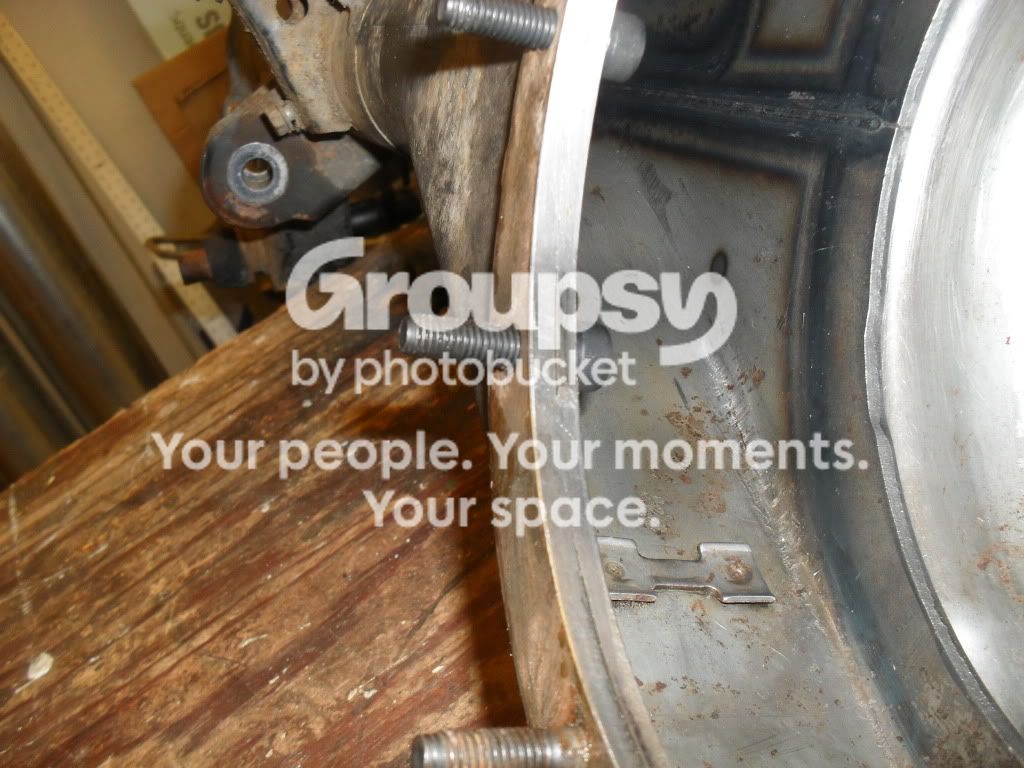

Managed to strip two bolts on reassembly, a sway bar bolt and the bolt on the center of the pumpkin that centers the e-brake cable. The mounts for the sway bar on the axle housing actually snapped off on a test flex. I guess it couldn't handle the stress with one bolt already sheared off. So I'll have to weld it on or something

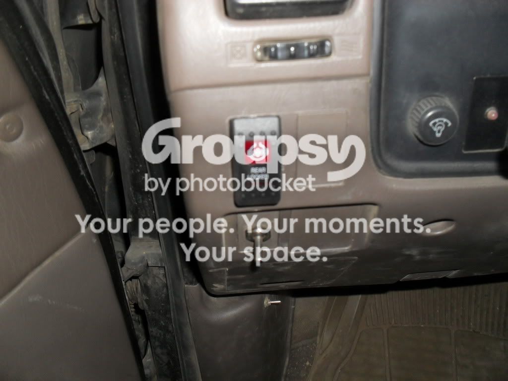

And my 4runner didn't have any prewiring. I had to buy the factory elocker harness, which I got for under $40. The rest I wired myself to my own switch. This is how I did it.

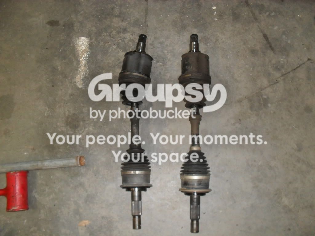

Been busy with the 4runner lately. Last month at Hollister Hills, I snapped both CV's in the obstacle course. We replaced one there at the trail with a spare, and I was able to get home on the other one being broken.

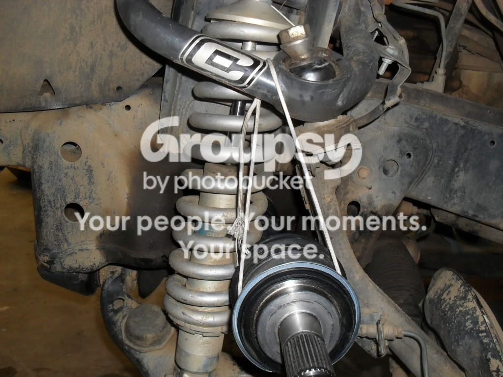

The goal was when replacing both CV's back home, to remove the front diff and replace my leaky oil pan. The 12mm allen bolt on the front diff had me stumped, as no stores around here had an allen wrench that big. So all I could do was replace the CV's and call it a day.
Trail fix

Original CV on the left with 230k miles...suprised they lasted this long!

New ones in...the paracord helped hold them up while I whacked them in

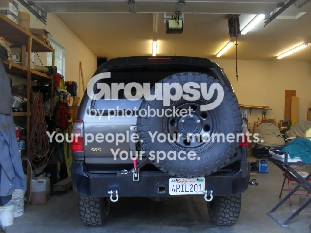

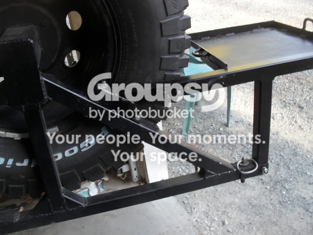

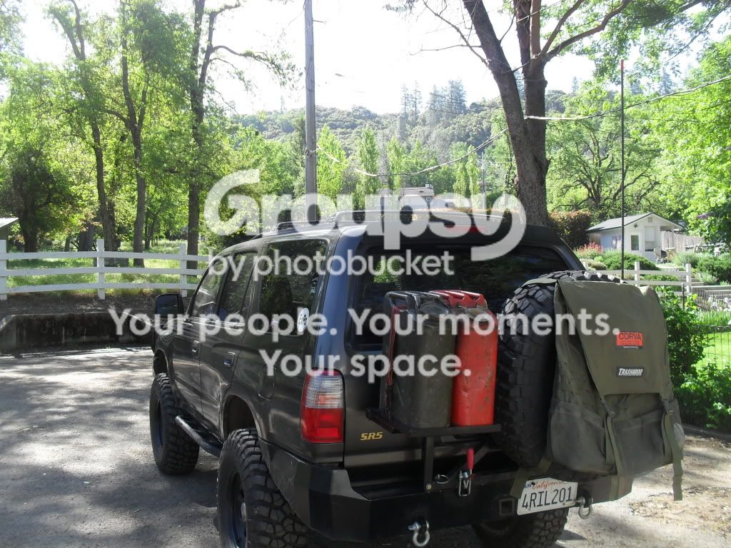

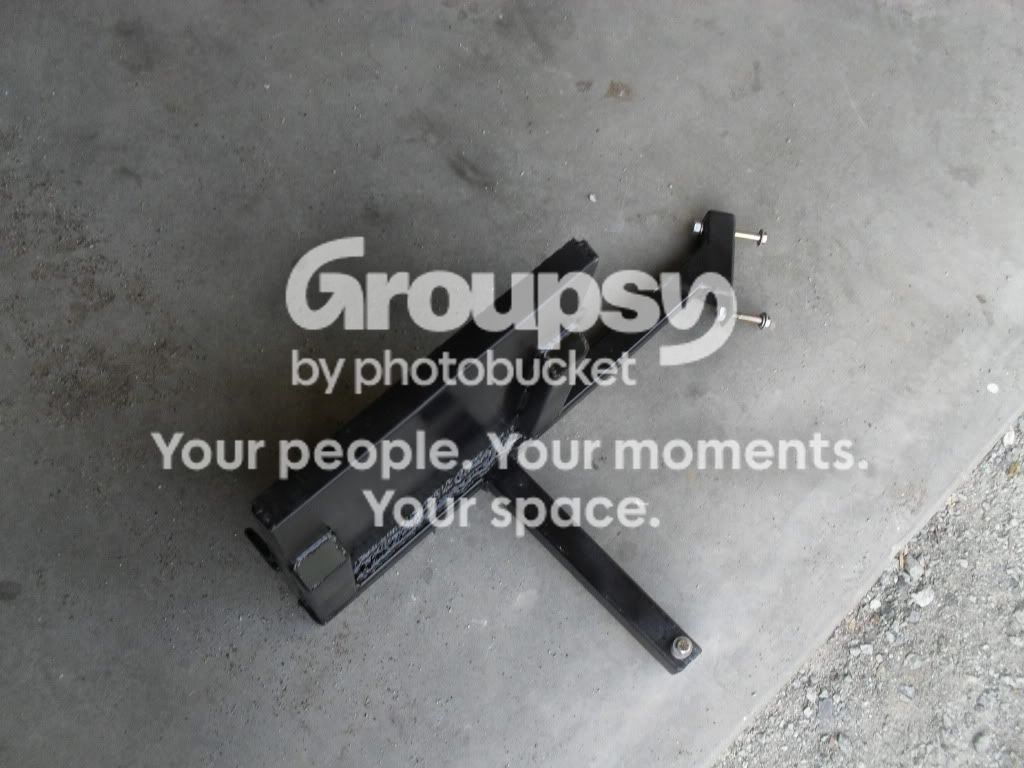

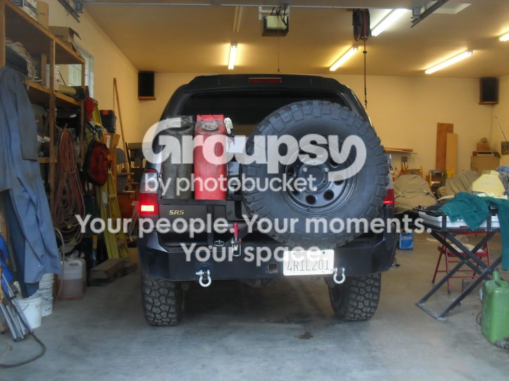

I also built myself a dual jerry can carrier. I wanted something I could take on and off, as I didn't want to drive with it on everyday. After a little fab work and tab making on the tire swing out, I created this...
SDC10523.jpg~original
Completely bolt on, it only takes 2 minutes to take on and off the tire swing out.
SDC10525.jpg~original
Tire only
SDC10522.jpg~original
Jerry can mode
SDC10526.jpg~original
