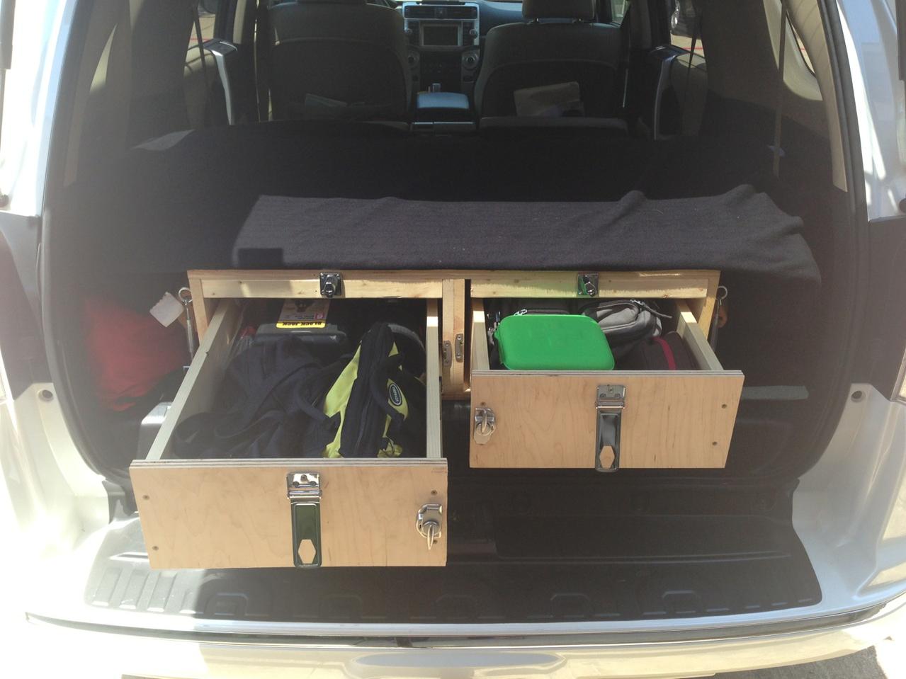

After reviewing everyones designs and being a novice at carpentry, I decided to take on the task of making storage drawers for my T4R.

Love the title...and it shows in your work. Made me think of 6th grade wood shop.
Seriously though *props* for taking it on and getting something together that works for you. You learn from practice - next time will be twice as good.
Do you still have all your fingers? Any screwdriver puncture wounds? Any smashed fingernails?
If yes, no, no, then good job son.
Looks great! I need to go back and look at SeattleMikes build for his TE and then look at Reata's build and do something like this for mine. Your drawers look fantastic
Nice work for being a "novice at carpentry"...:trophy:

Looks good! I could see a lot of function with something like that. I like how it's secured to the floor.
well....
it sure looks sturdy!...:spit:

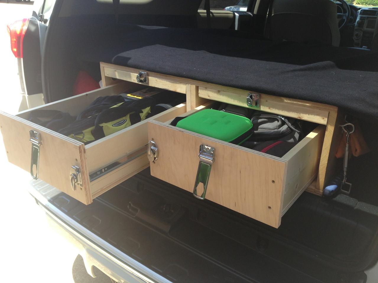

Why is there only slides on one side and not the other?

Thanks! As being a novice carpenter, I didn't align the center piece correctly. The left drawer is a bit tight when fully extended which in turn caused the right to have more slack. Since I screwed the mess out of the center to secure it to the top, I didn't want to unscrew it all. Genius at work. I placed the right slides on the bottom to still make it functional.

Straight line . . . I suffer from that as well and that's why I had Lowes cut the wood to my specific measurements,lol. I would attempt to cut my wood if I didn't live in an apartment and had my own garage to house the tools I want.
Looks good. Throw some paint on it and call it a day. Always feels better when you do it yourself. Mine isn't perfect but I feel a sense of accomplishment when I can say I made it on my own and people are impressed.

ON your next one, mount the slides to the drawer, slip it in the sides with the bottom loosely attached, then screw or nail the top on there. It will align each and every time. Kinda doing things backwards but self alignment is the key here. Good job.
