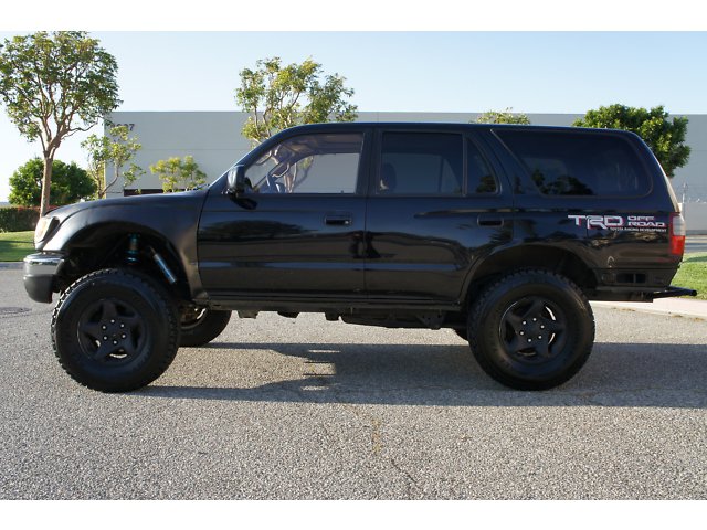

Hello there,
I have a 1997 Toyota 4runner that I bought used. When I bought the truck it had been modified to a pre-runner setup in the front and the previous owner took out the 4x4. Besides the 4x4 taken out, the slip differential also seems to be taken out?
Other than the fact that the truck is no longer offroad capable, it is running great, and looks good too.
I want to re-instal a 4x4 in the truck and wanted to know if anyone has any good suggestions for what I should be looking for? Maybe a straight axle setup? Any feedback would be great. Would like to keep the budget below $1500 so any good suggestions would be awesome...

Your previous owner probably pulled the 4wd because the CVs were in the way of his longtravel front suspension setup, and to save weight. It's plenty offroad capable right now, for sand bashing and light trails. The easiest way to add to that capability would be to put a locker in the rear. If you really need 4wd back, you're probably going to have to redo most of what the previous owner did. If he swapped the transmission for a 2wd unit without a transfer case, you'll need to find another transmission. Then you'll need a front driveshaft, front differential, CV shafts, and to figure out how to get those shafts past the coilovers, or uninstall that longtravel and go back to factory control arms.

what long travel kit does it have up front? what spindles are currently attched to it..take more pics and post em up...if its total chaos you can still run 4wd..just need to know whats missing. for under a grand you can get the long axle shafts and be up and running 4wd...

Thank you everyone for your input! I really appreciate the feedback! I will take some photos of the current modifications and maybe someone has some good recommendations. It is running as a great 2wd truck but when it snows here in Tahoe it has the ability to get stuck in about 1' of snow spinning on just one tire.
