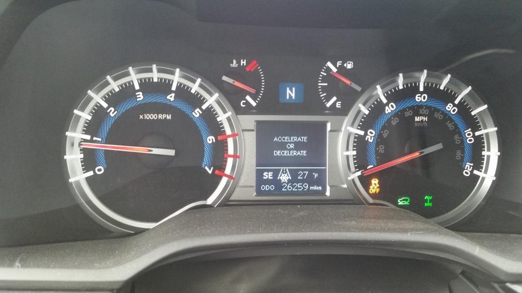

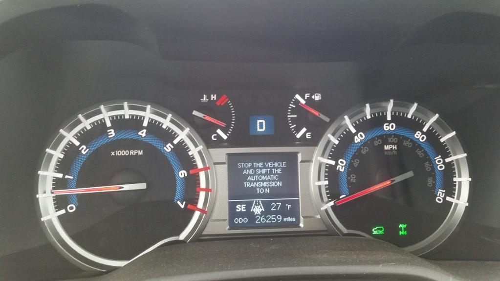

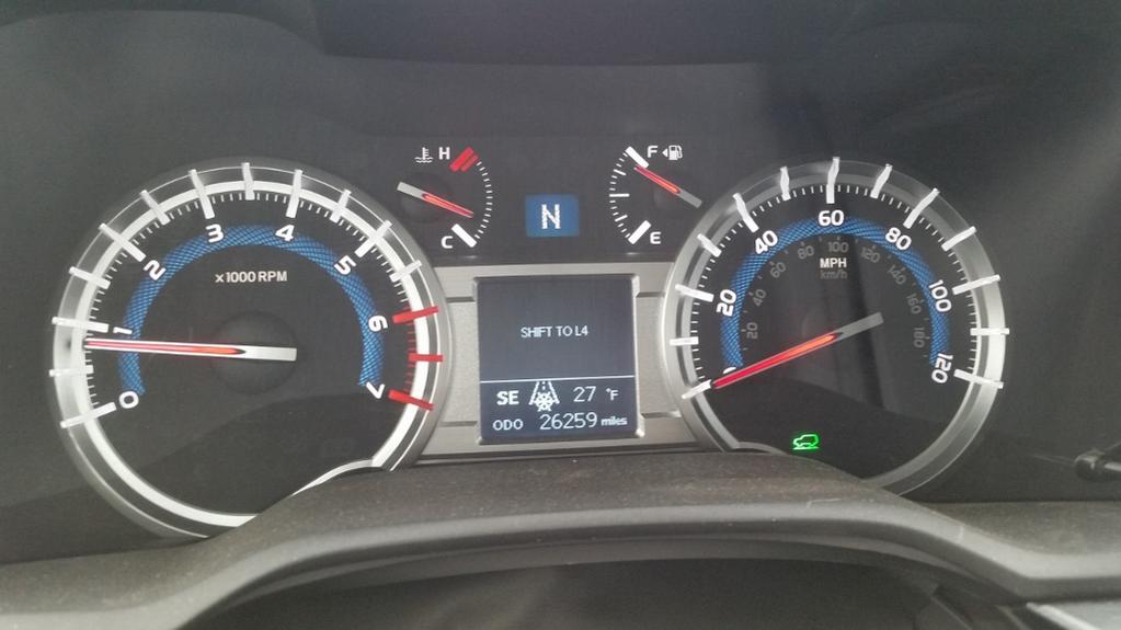

Not sure what to make of this, but I found it kinda odd.
I made a "creative" parking spot at the ski hill yesterday. Getting out took a little bit of finesse - meaning I needed 4lo - locked rear diff - and everything short of winch or airing down to work my way back out of the deep snow. Not really a big deal, but exiting the parking lot I stopped and shifted back to 4hi with the trans. in neutral.
Then I got the following warnings on my dash depending on whether I was in 4lo 4hi or N:
No amount of shifting around the transfer case lever solved it. I was able to drive normally without any noise or adverse effects I could feel. I pulled off the road and turned off and restarted and then got the ABS/VSC and MTS lights lit up with flashing 4x4 light. Then within a mile or so it all went back to normal. 4x4 always seemed to work normally.
It's all back to normal now. My only guess is the ADD actuator - but I don't know why that would ask to put back in 4lo. Or something internal not correctly registering the transfer case lever location.
This is on a TEP - so the transfer case is manual shift lever. Nothing seemed amiss with the shift lever. I really have no idea what could be the issue other than a sensor thinking 4lo was still engaged?

If you still have multi-terrain select on when you shift to 4hi, it will prompt you to shift back to 4lo. One setting on MTS (all the way to the left I believe) will still work in 4hi below a certain speed.... so it does not immediately cancel MTS when you shift to 4hi, however if you are in one of the 3 other settings, it will tell you to switch back to 4lo.
If you ignore it, it will stop, and the MTS light will go away.
This is what I deduced anyway. I've had the same thing; the dash telling me to change the Tcase position. I've never had any issues.
I might have misunderstood your particular situation though.....
