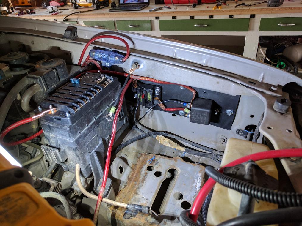

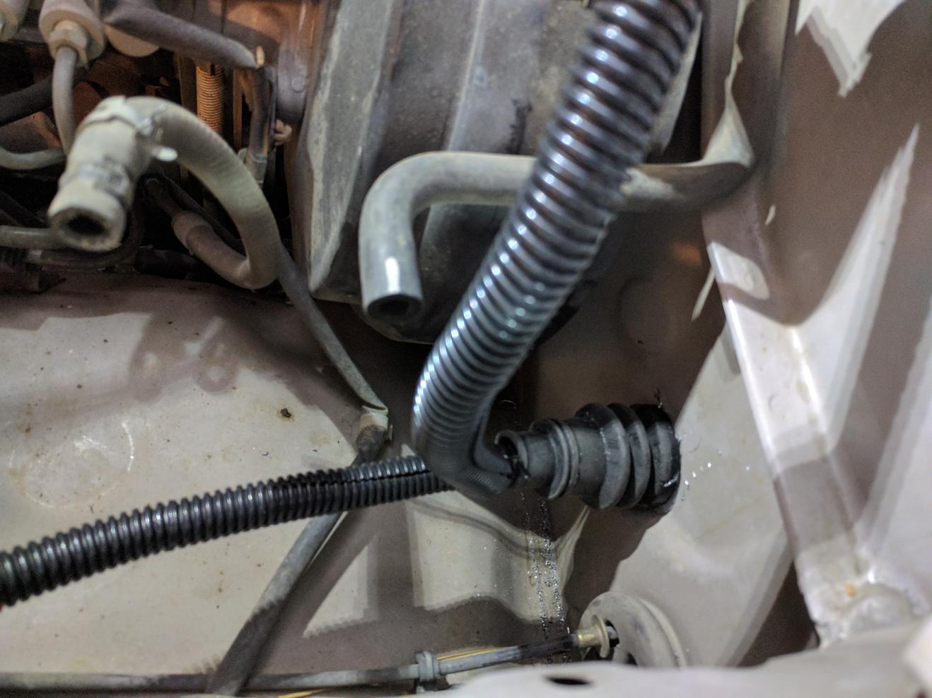

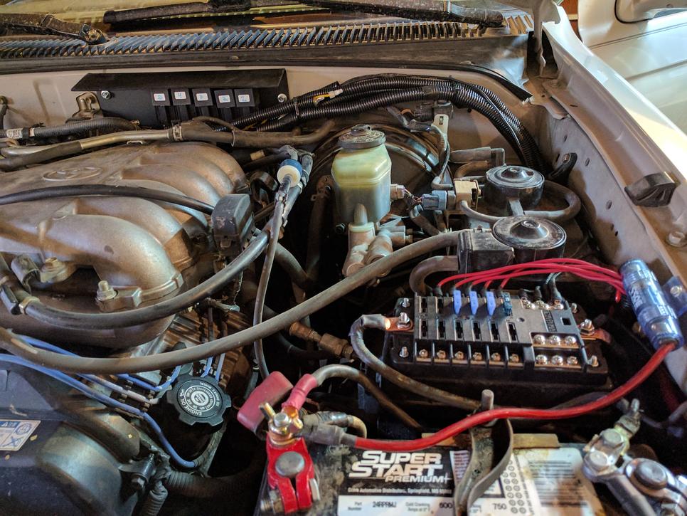

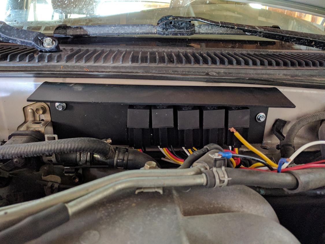

Drill a new hole. You have to remove the charcoal can to do it. I'll attach a few photos I have. I need to find a new photo host. Both Google Photos and Imgur can suck it. More about that rant later in my thread. lol
The order of my system goes like this:
Battery to Bussman 100A Breaker.
Breaker to 100A Relay.
100A Relay to Blue Sea Fuse box. Relay to add a circuit on 10A swiched Turn fuse in cab.
Blue sea to 40A relays.
40A relays to after market accesories. 40A relays to in cab rocker switches.
All grounds on the SAME circuit get tied together and connected to blue sea box. That makes future ground issues easier to track down.
I pre-wired 5 40A relays. 3 are in use.
[MENTION=57546]4-Ripcord[/MENTION] didn't have his electrical plate made for the 97 yet. If he had I probably would have just purchased that from him. My way does hide hide the 100a stuff behind the battery though.
Here's a few photos to help you get the idea.
