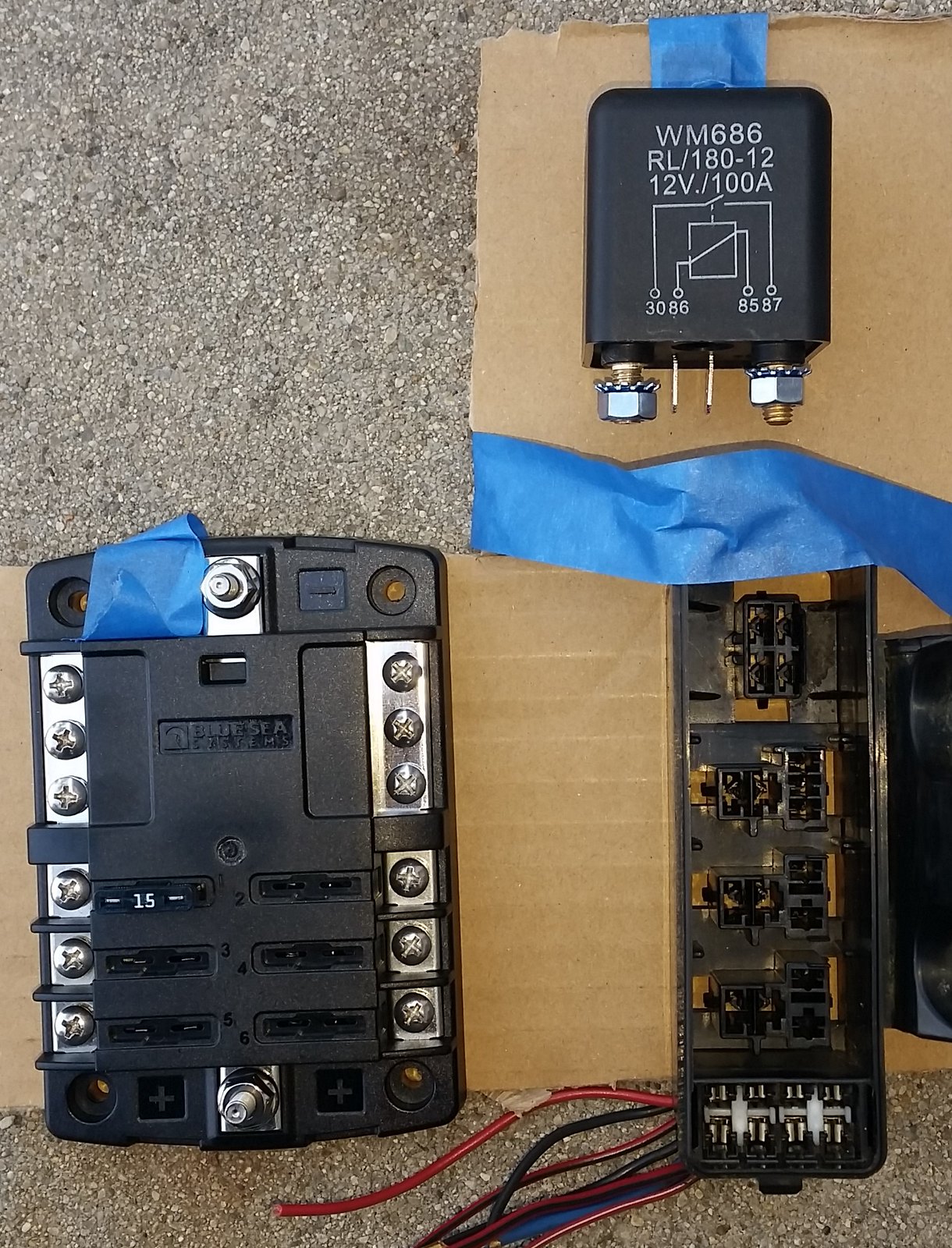

So I'm finally getting around to doing this project, and wanted to get your feedback on the plan before I go down this path too far.
I honestly think that I managed to use bits and pieces of everyone's ideas on this thread, no small matter. See if you can find where your ideas were noted and implemented :).

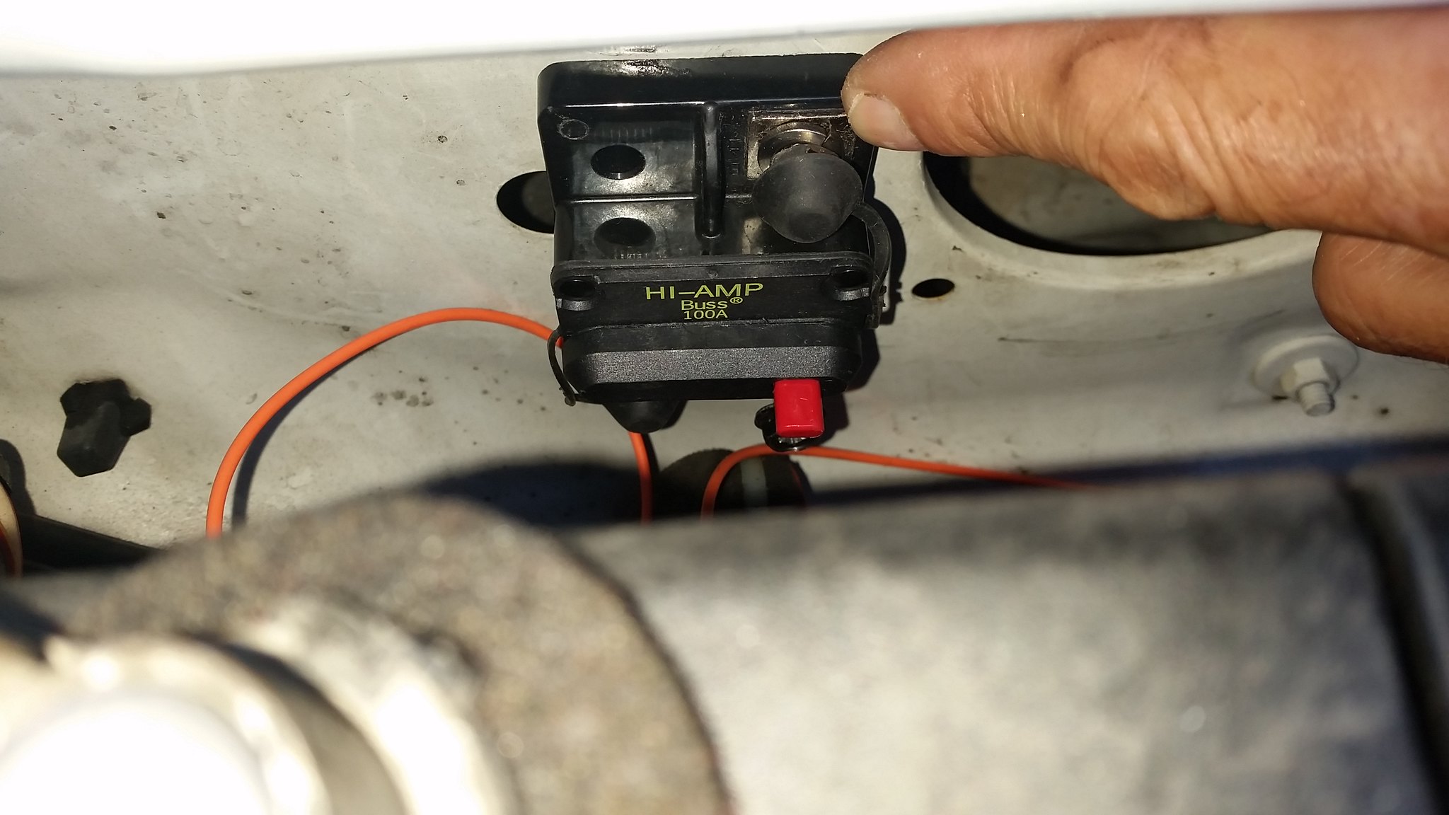

My plan is to place the 100A circuit breaker in the engine compartment, on the driver side fender:
Everything else will go inside the passenger compartment, to keep it away from heat, dust, and moisture. The wire from the circuit breaker will pass through the Daystar grommet in the firewall.
On the inside of the firewall, below the grommet and to the left of the steering column, I'll have a plate to which I'll mount the Blue Sea 6-fuse box with grounds (left), the 100A relay energized by ACC (upper right), and a Corolla fuse and relay box for the few relays that I might need (lower right):
Here they are mocked up on the piece of cardboard, I'll use 1/4" plexiglass:
Any thoughts/comments/criticism? I'd rather hear it now than after I get all the parts and start slinging wires :).
IDK man, I would keep all the big wires in the engine bay. That's the whole point of using the relay. Small trigger wire opens the larger circuit. The less distance between the battery, circuit breaker, relay and Blue Sea box the better IMO.
if you need any extra connections... I have always wondered if one could get the entire non engine wiring harness out intact. spoiler alert, you can.
<a href="https://imgur.com/dyA4JY3"><img src="https://i.imgur.com/dyA4JY3l.jpg" title="source: imgur.com" /></a>
I hear you, and I considered a number of locations for the Blue Sea box. Everything from right above the existing fuse box in the engine bay (like your build), to right next to the driver side fender hinge (sleepydad), to under the rear seat (kolelt), to all the way back in the rear cargo panel (violation).
I'm leaning towards the under dash location because in my case, that's where most of the loads will tie in - seat heaters, mirror heaters, power outlet circuit, etc. So I'll have one big 8 ga wire come through the grommet to the fuse box, but then the individual load circuits will tie right into the box without having to go through the grommet and into the engine bay.
I've always read that you want the fuse box to be closer to your loads, not to your supply. Sort of like why you put a subpanel in a home if you want to have a bunch of breakers in a distant location, and run a big cable from the main panel to the subpanel. So if most of my loads were under the hood, I'd probably mount the fuse box there, but I think mine will mostly be in the passenger compartment.
In the end I think it's a toss up (it's only about a three foot difference in cable length), so provided the cable is sized adequately, it doesn't make a difference. I did think that it'd be nicer to have the fuse box away from heat and moisture, so that's why I'm leaning towards the under dash area.
I do think that I may move the 100A relay into the engine bay, near the circuit breaker. First, I bet that sucker is loud when it clicks (I'll test it tonight), so I don't know if I want that clicking under my feet every time I start the truck. And second, it would mean that the portion of cable in the engine bay from the relay to the fuse box under the dash will not be "live" when the key is off. I don't really see an issue with having a "live" cable (the starter cable is "live" too if you decide to cut through it :D), but it does seem like a small benefit, so why not.
What do you think?

That's quite the spaghetti of wires! I actually did consider pilfering a newer (99+) harness and fuse box for my '97, thus getting the OEM fog light, heated mirror, and power outlet relays and fuses that mine doesn't have - but in the end decided it's too much of a project. You're obviously braver than me!
I do plan to snag a long section of an OEM harness at the junkyard to have some OEM wires on hand. Just makes the job look cleaner IMO.

no idea why but now I have a complete intact engine/cabin wire harness from a 99 sport on hand.
if you look at the way Toyota did it, the battery and alternator are very close to the fuse box. then loads go out from fuse box with correctly sized wires. I think that is a good pattern, they seem to know what they are doing. most of their relays are also very close to the fuse box, except the transmission relays and they are scattered around the truck. transmission guys missed the memo.
I have more experience with marine wiring than auto. In marine stuff long runs are more common. fuses have resistance and they are designed to blow so putting them farther away from their source voltage might not be best practice. If you had to design an entire truck system you would take a different path than us crazy owners. putting a fuse right before each load and then having to dig or tear things apart to find the blown fuse, yea not good.
having a one stop location for under the hood and inside the cabin was really my motivation.
your plan looks good to me, it's a pain but it's worth it. future you will thank past you, maybe.

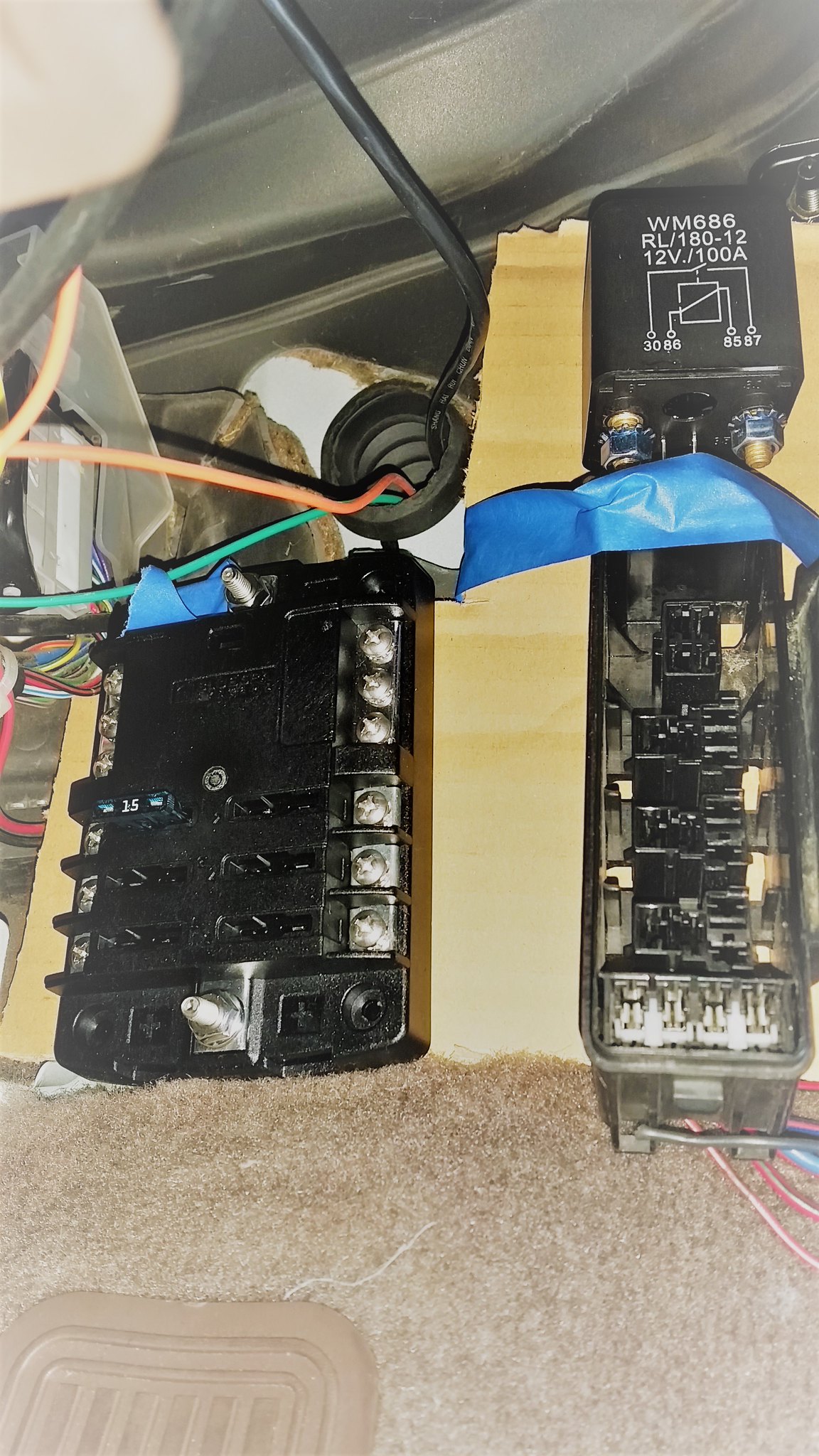

I forgot to update the thread once I finished the project, as I often seem to do.
I installed some rivnuts in the inner fender to mount the 100A circuit breaker and 100A relay:
Then attached them with M6 screws:
Everything was connected with 4AWG welding cable - from the battery to the circuit breaker, to the relay, and to the fuse box inside the passenger compartment.
I added the Daystar grommet as recommended by others to provide an opening in the firewall. Below is the grommet with some wires going through, and the mounting brackets I fabricated for the plastic plate on which the BlueSea box and Corolla relay box will be mounted:
Here is how the fuse box and relay box are mounted to the plastic plate:
All the circuits completed:
