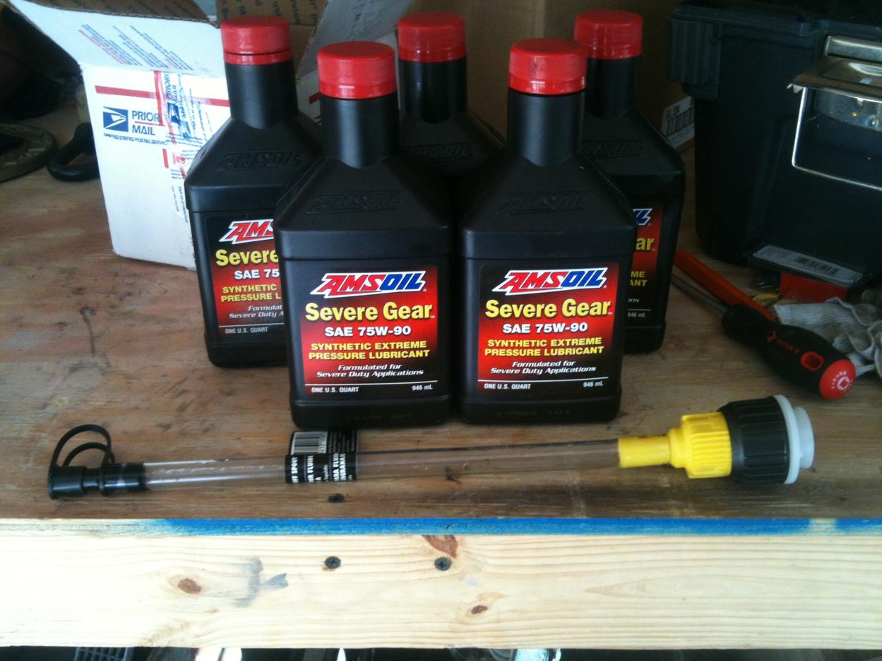

The title says it all. I started at the rear diff replacing all fluids with Amsoil Severe Gear Synthetic Oil. That went fine. Next was the transfer case, all well there too. Next I removed the skid plate to get to the front differential. I started with the fill bolt and it was a B!TCH to get loose with a 10mm wrench. I PB Blasted them both. I went for the drain bolt next and it was even more of a booger. Eventually I thought I got it loose but turns out I stripped the bad boy.
