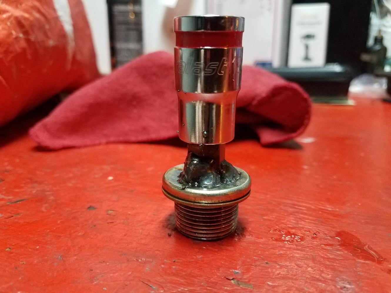

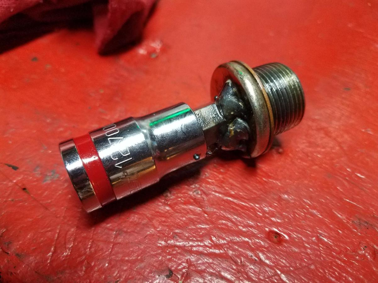

So after deliberating, the direction we ended up going in was to weld the 12mm hex into the drain plug. I was reluctant to want to pound on a chisel trying to slowly turn it counterclockwise for fear it would slip off and mar the diff housing. With the hex socket tack welded in place the drain plug easily loosened with barley much effort at that point. Probably the heat did help some with that as well but I'm sure with the socket firmly secured made most of the difference.
Tim [MENTION=120071]mtbtim[/MENTION] met up with me down at his buddy Wes' shop in Morgan Hill, One Off Customs, and Wes welded the hex socket into the dp. Tim wanted to do a video so he'll have that available on his YT Channel Timmy The Toolman. Tim did a great job of narrating and providing instructional ideas for a various solutions so I'll let his video be the guide rather than me typing a whole lot of 'you could do's' here.
Also, when I bought the replacement drain plug from Toyota (PN# 90341-24014) the replacement DP is now a 10mm hex, to match the fill plug. So next time around I now only need one 10mm hex socket. Great.
