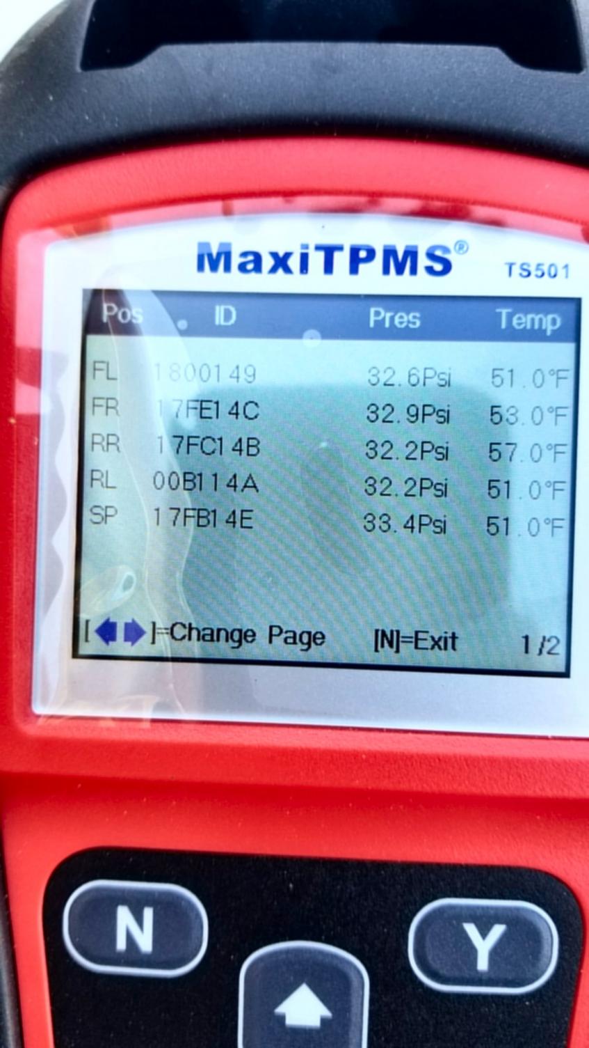

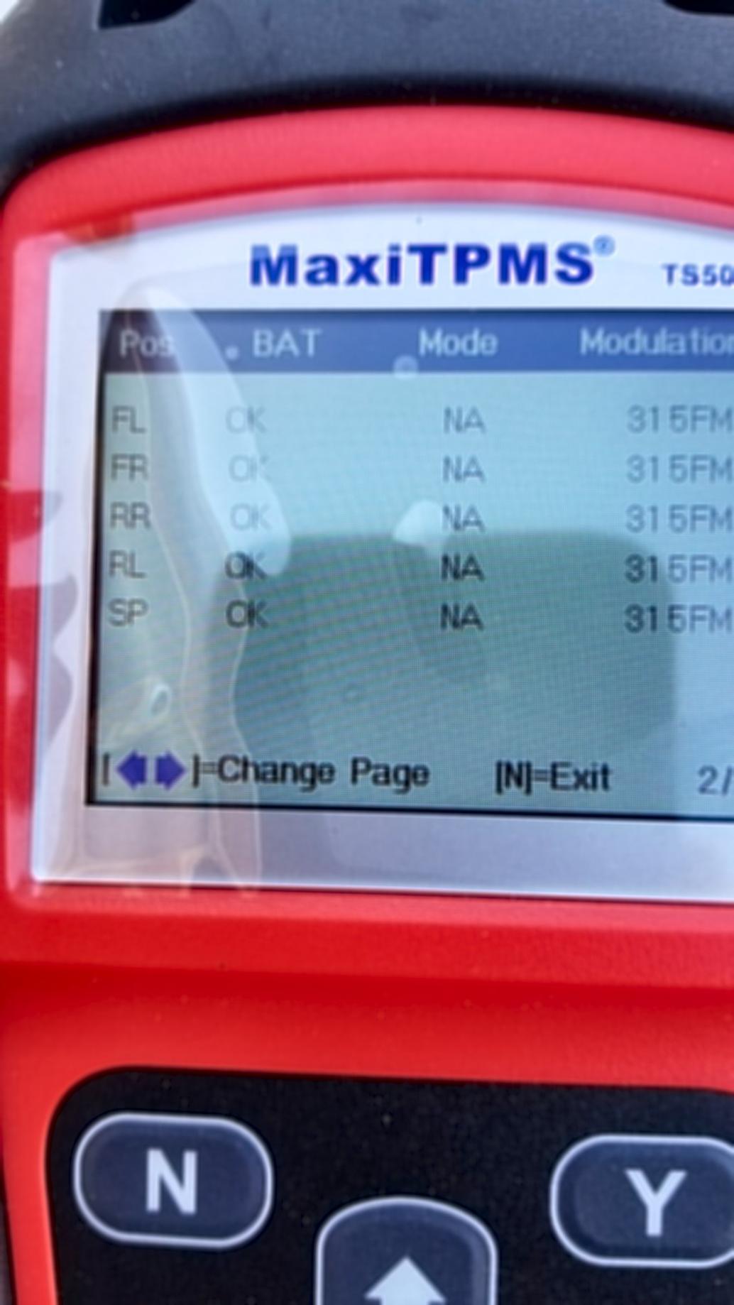

I bought the Denso sensors on Amazon, paid a tire dealer $25/tire to install them and bought an Autel MaxiTPMS TS501 for $200 to write the new codes into the TPMS computer. It was still cheaper than having Toyota replace them and now I have the Autel device that lets me walk around the car and check each tire's ID, temp, pressure and TPMS sensor battery level.

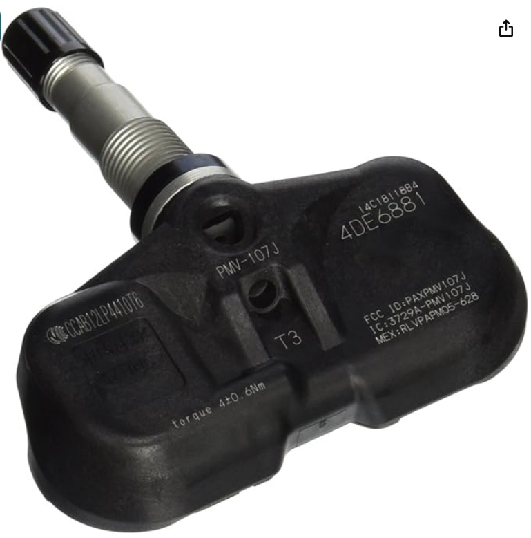

The stem is part of the TPMS sensor. The sensor would have to be replaced. You can replace just the one if it's of the same brand as the others but I would recommend replacing all of them if they're over 5-6 years old.
Here is what a sensor and stem look like.
