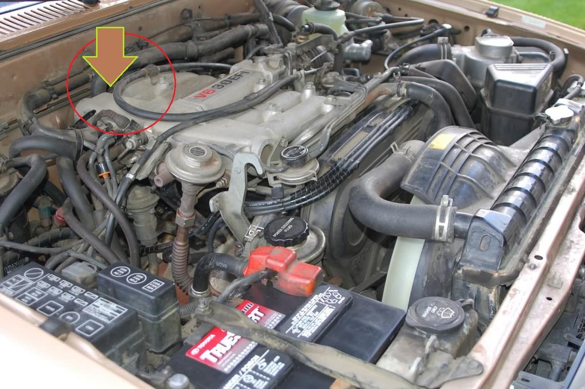

if you reach up the middle part of the plenum and slide your hand underneath it, in between the fire wall, you should see if its leaking gas. or get your phone and take a video from the passenger side to look at the part.
I attached a photo pointing to where it is if it helps.
I tried to reach down in where the arrow is but there is no way I can feel or see anything in there. I don't know what I'm feeling around for, I can't even find the fuel rail but thanks. I am going to try again, pic is very helpful.
Okay I got my fingers on the dampener…and it is leaking…. yippie.
No way I am spending $150 on this thing from toyota, I have to take my chances on the aftermarket..
