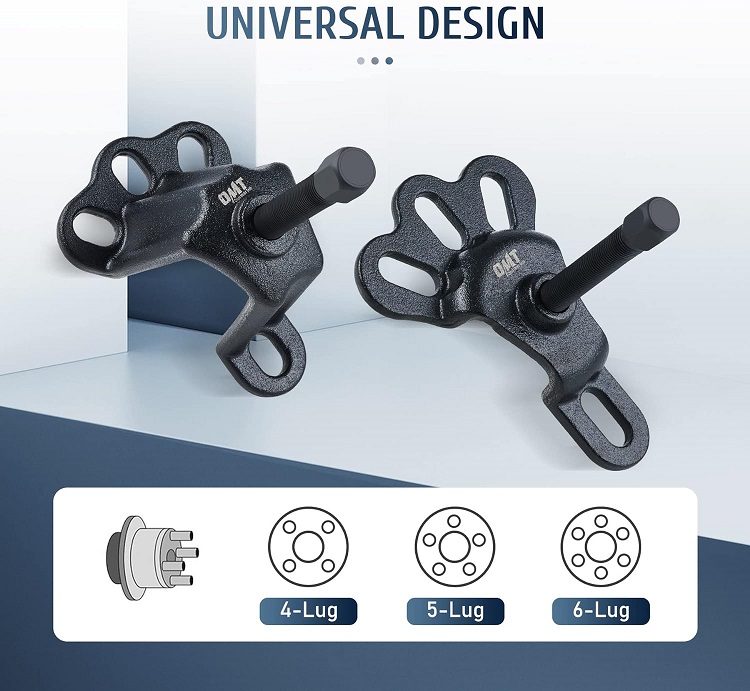

I'm wondering if anyone has ever had success with one of these pullers. It says it the big one fits a 5.5" ID.

That puller seems like it would work. It will probably let go with a bang. There will be some rust under there for sure. Rust glue.

I've never had one that took more than a couple taps with a soft hammer and I live in the rust belt. I think that puller setup is the best idea at this point. Maybe borrow one from your local auto parts store?

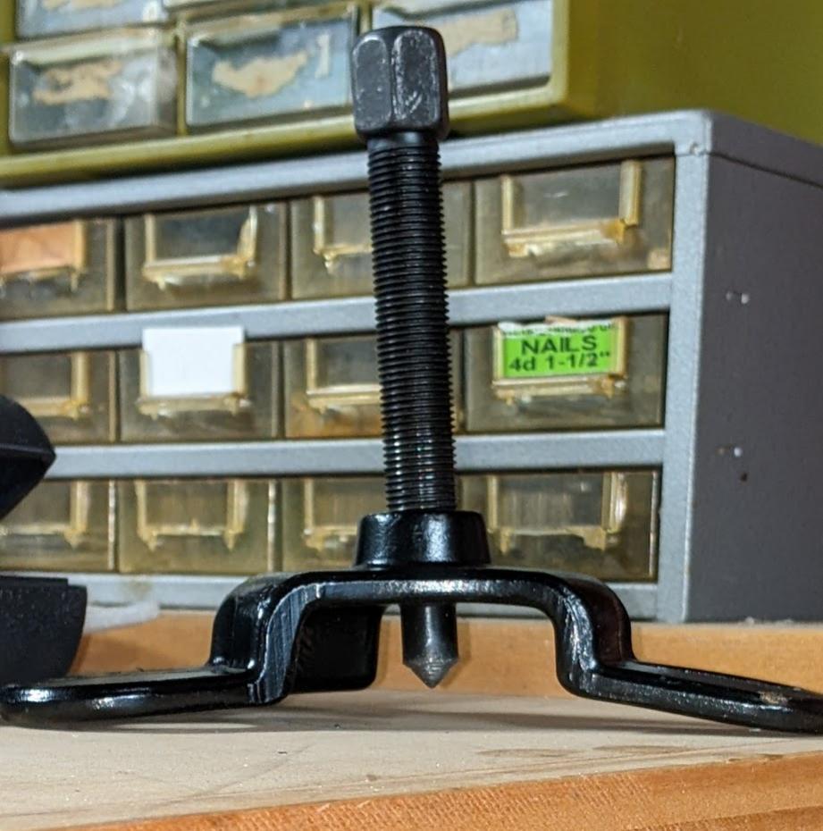

Long story shortened...I bought the hub puller off of Amazon. The larger of the two fit, not great, but it worked. I cranked it down until it started bending and then applied some heat. When I cranked some more, the axle started moving. There was a pretty good band of rust on the splines. Problem solved? Of course not.

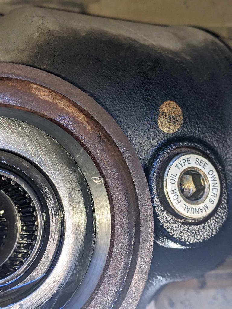

Getting the old seal out, I managed to gouge the diff with the seal removal tool. Luckily, it was mostly near the outer edge so I deburred the gash with some emery cloth, cleaned it up, put on a dab of high temp RTV, and installed the seal, and then a re-booted axle. So far, 2 days and no leak. Fingers crossed. But....

Good to hear that you got it off. The gouge is no biggie. My guess would be the backing plate too. There's some parts of it that run pretty close to the rotor. Hopefully it's that simple an issue.
