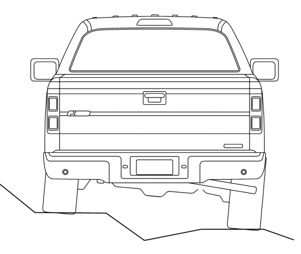

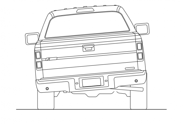

I've carefully read over your discussions, and to sum up your points, you posit that this sliding disconnect will have no impact on available upward wheel travel because the sway bar will not impact articulation offroad. However, the sway bar does make a difference in sway control on road, at high speed.
That is not the case. The concept that these sliding disconnects would make no difference would be predicated on the idea that this suspension loading situation at high speed (truck turning right):

Is different than this suspension loading situation off road:

As you can see, that is not the case at all. The suspension loading is precisely the same in both scenarios.
A sway bar, as our trucks have, is a simple linear spring that connects one wheel to the other across the chassis. If both front wheels move together, no force is induced by the sway bar. If only one wheel moves upwards, the sway bar will resist that upward movement in correlation with the sway bars' effective spring rate.
By allowing the sway bar some free-span on the sliding link, it will induce less force overall to the extremes of available wheel travel.

I agree with your description regarding weight of my truck on a swaybar. What I do not agree with are the two diagrams. The lower diagram is not possible under any circumstances. In a high speed turn, the center of mass shifts to the outside, in a low speed turn it does not. The second diagram shows the truck level and the suspension flexed in an offroad situation. This is impossible. If the wheels are connnected via a torsional spring, lifting one wheel would tilt the vehicle approximately 1/2 the total difference between the left and right wheels, this tilting is an exact approximation of the lateral forces during a high speed turn. By lifting one wheel, you are merely causing the truck to approximate what would happen during a high speed turn by moving the center of mass downhill. It is simply not possible to lift the suspension of a vehicle on one corner without a slight tilting of the body.
If you are talking about a hypothetical situation where the body of the truck is mounted on a rack that is holding it static and a "terrain simulator" is used to actuate the wheels up and down, then the lower diagram seems more plausible.
Furthermore, if I read your point correctly: Because my off-road vehicle is equipped with devices of greater mass that would enable one to go off-road, the now equipped off-road vehicle performs differently than an on-road vehicle, even to the point of making devices like a swaybar disconnecting system completely useless and of no beneficial function under any circumstances? If so, I agree.
If you've never seen the lower diagram happen, you haven't wheeled with other people much. When your behind another vehicle out on Elephant Hill or in the mountains above silverton you can watch this happen on a stock Nissan Titan much less an upgraded 4Runner. Sure, the vehicle probably wouldn't sit that flat, but that's true of both the top and bottom diagram.

The only time I've seen the back end of an offroad rig look like the lower diagram is if there's appropriate flexing in opposite directions between the front tires and the rear axle.
If you park a truck sideways on a flat inclined plane, the CG of the truck moves laterally towards the low side, and causes the suspension on that side to compress, which is basically the opposite of what the lower diagram shows.
