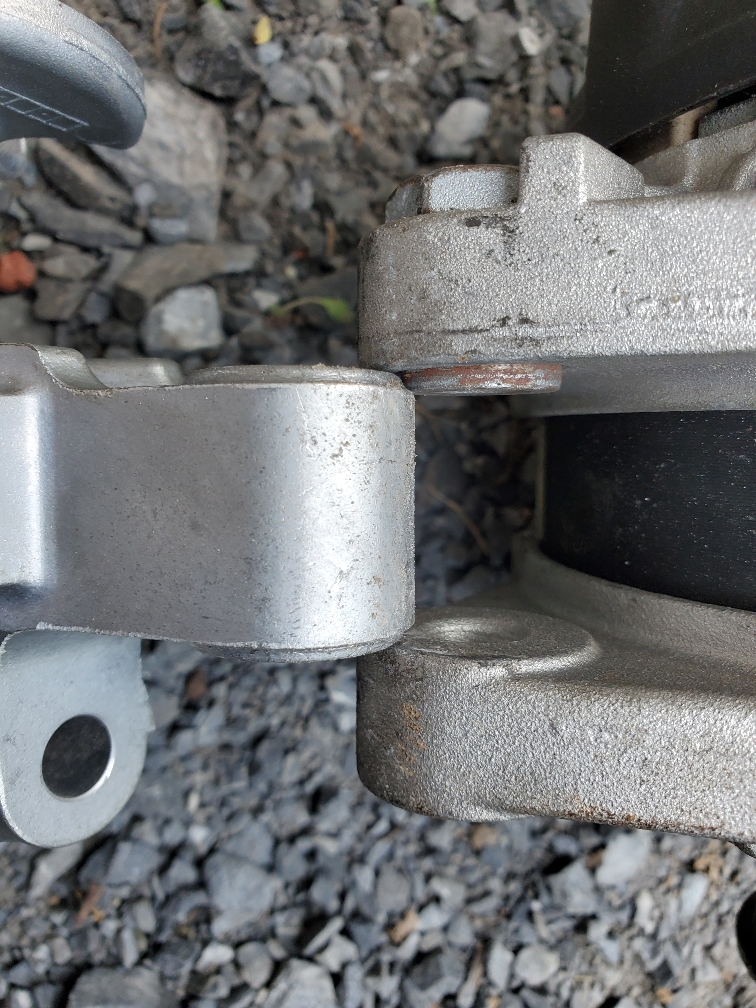

So I was going to replace the whole tensioner but I decided to just do the pulley and see if that fixed my issue, mainly because I currently can only work on a gravel driveway and its cold today!
Anyway I went to throw the alternator back in which is aftermarket and was replaced by the previous owner. It will not go back onto the tensioner. O even tried out of the vehicle and there is a little lip preventing it. I dont even know how the guy got it on the first place. What am I missing?

Install it from the top and give it a few love taps with a hammer? I'm not familiar with the alternator but I am a helicopter mechanic and that's what I'd consider doing if I ran into an issue like that. Looks like the lip on the left would allow the lip on the right to give a little and slide over.

Is that lip part of a bushing that can be pressed further out?
Yes it is. You can take a plastic mallet and tap it and it will move. It's designed that way. Makes it easy to install and when you tighten it up it will slide back out until it makes good contact.

I have now discovered prior to coming back on here that is s sleeve that is designed to move unfortunately for me mine wouldn't move back. I tried hitting, heating, spraying tapping. Those are what I tried prior to going to the parts store for a new alternator.
Then I had the bright idea of using cutoff wheel to get it out of there.... Little bit of burnt belt and a frozen pulley later I put the new alternator in and all is good.

Since the alternator didn't have the spacer (since i cut it off) the pulley wouldn't spin freely once tightened down which burned a bit off the belt but it still looks ok so I'm gonna leave it. Hopefully that's not mistake lol Im gonna keep the old one and my ratchet in the back just in case.

We had the same problem when we replaced our alternator. We just used a file and took a little off at a time until it fit.
Thats a good idea I didn't think about. I was a tad stressed since it was slowly getting dark out and I wanted to get it done. All better now and today I did the rest of the pulleys. So quiet!
