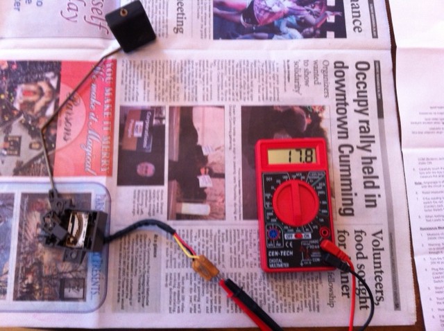

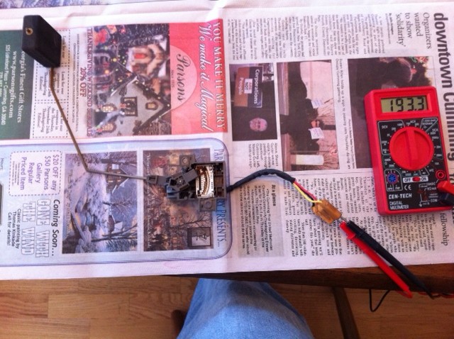

OK, well I finally got around this past weekend to dropping the tank and removing the fuel pump and sender unit. The fuel pump "arm" was definitely bent, but didn't see any damage to the fuel sender unit.
So, I tested the fuel sender and it "seems" to be working correctly...it runs from about 190 (empty) and 18 (full). I think it's supposed to be 180 to 10 ohms, but close enough.

Yeah, I've been huffing fumes for a few days now...no fun. Well, I just did a test with the fuel pump/sender assembly still apart from the tank, and the gauge is operating again. Maybe the twisted fuel pump arm wedged the sender float arm against the side of the tank, or somehow caused it to short out. I think I am going to just hope for the best and put it all back together tonight. I will post back when I'm done.
