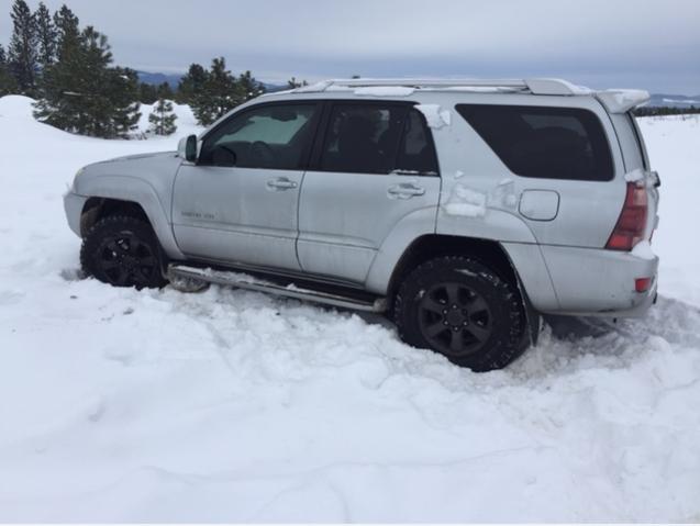

Well this is my first year in snow. I got stuck twice. The pathetic part is that its not even deep snow.
The first time is about 12" all around.
This morning 2" of snow on 3 tires and 12" on 1 tire. Trying to leave for work.
I know I need new tires. They currently have bridgestone revo's 3-4 32'nds left.
Anyone else get stuck this easily. I love the truck and knowing I can take it almost anywhere is the reason why I did not get a Forrester or kept my Outback.
That's just wrong, I have to ask - did you put it in low?
Yes.. And rocked it back and fourth. Wheels kept spinning. My 2 year old who starting to put words together "daddy you ok?" :(

If you're still stuck, try using ATRAC to get out. It should work in 4HI or 4LOW, but 4HI should be fine for this. First lock the center diff (button with 4 wheels and an X in the middle, and make sure the light on the dash finishes blinking. It might take a couple tries if you're not rolling). Then give it steady pressure on the gas to keep the engine speed around 1000-2500 RPM. You should hear/feel the ABS system clicking right away. Let it do that for several seconds and you might make progress. Revving it higher will not help, and that will just disable the system and get you more stuck by digging a hole. Also I think putting your foot on the brake while also on the gas disables ATRAC, but I'm not 100% sure. If you've already polished the snow smooth around the wheels it could be hard to get out without a little digging. A folding shovel is a great investment for winter.
If that doesn't work, try lightly setting the parking brake (maybe halfway?) while carefully applying the gas just enough to get going but not spin the wheels. It's a long shot, but it could work. Basically a poor man's limited slip diff.

Ill try that in a hour from now.. heading home in a bit..:rockon: I locked the diff this morning.. but was in a rush to get to work.. threw some deicer around the tires.. Ill get it out, but just didnt expect to not move in such miniscule snow.. I expect a lot more from the 4runner. Tires in spring.
