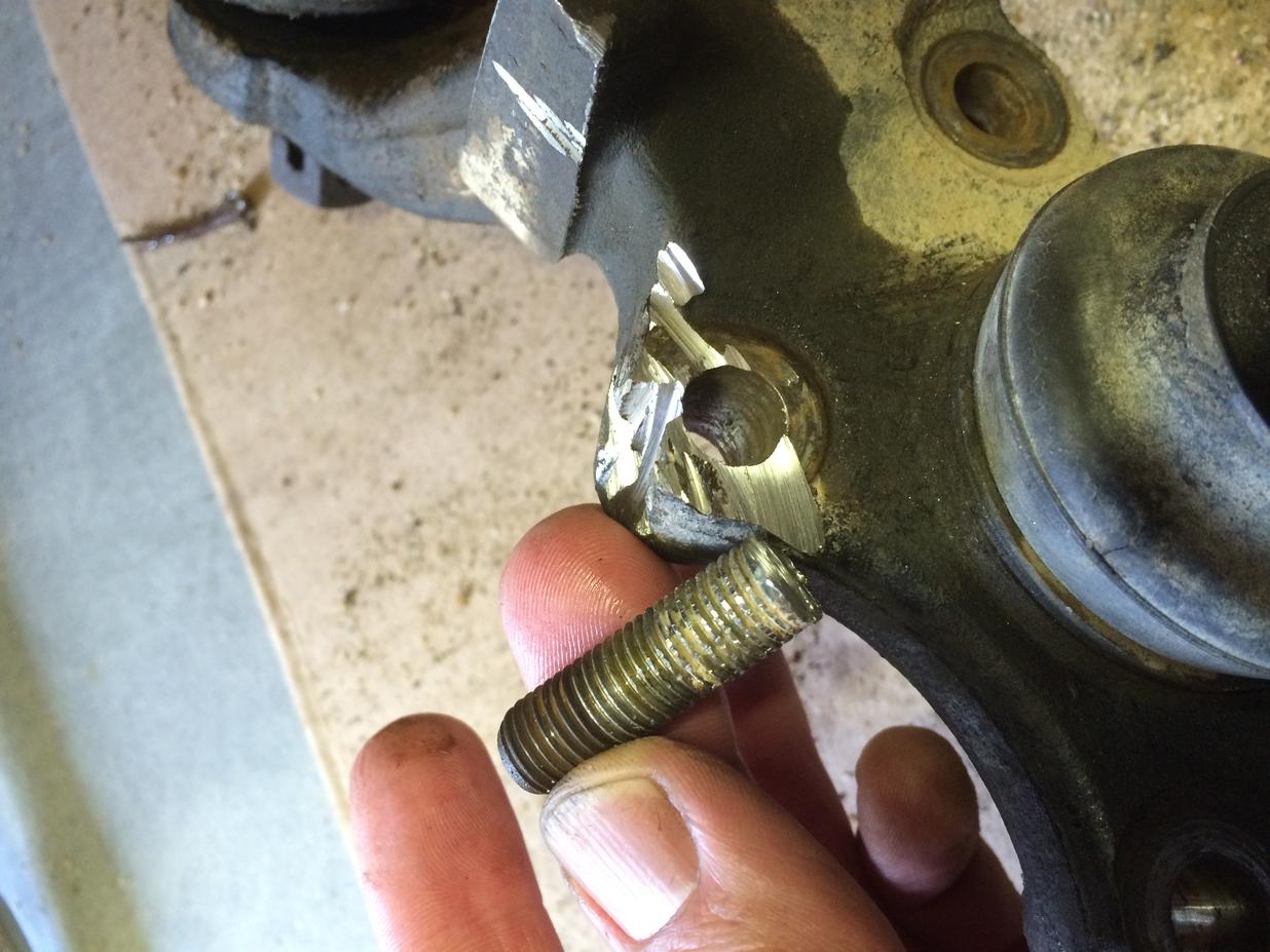

I rounded one of mine back in the winter when changing lbjs. I tried one of those tools for rounded bolt heads which did NOT work. I finally got out my angle grinder and ground the head off of the bolt (I had purchased new bolts with the LBJs). The ball joint flange that the bolts go through aren't threaded so once the head was off, it slipped off. Oddly enough, then what was left of the bolt unscrewed as easy as pie. (Disregard all of the excess grinding - I was getting pretty frustrated - LOL)
Once the tension is removed by cutting off the head the bolt will often come out easier.
