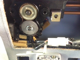

I just bought the 2000 model. After opening the sunroof yesterday, it got stuck. I tried the reset, but it didn't work. Now I am trying to manually close the roof. How do you remove the motor assembly? I took out three screws and two bolts, but I still can't pull it out.

Ok so I went to a local pull a part and got a new sunroof motor. I bench tested it before installing it and it worked great. Installed the new motor and still nothing...
So I started doing some more digging. With the motor taken off the sunroof should move freely. Well mine would not at all! Now when you take your motor off you can see where the motor gear goes into a little box where you can see two cables. I disassembled the box and found 4 copper tubing's, 2 on each side. There is a cable for the left track and a cable for the right track. You can pull on the cable and they will come out, the excess cable goes into one copper tubing while the other end goes to the track (hard to explain you would just have to see it.). I took some pliers and tried moving a cable manually and my left side of the sunroof moved, but the right side was locked up. I saw the cables were looking in rough shape so I decided what the heck I will tear this thing out and restore it.
