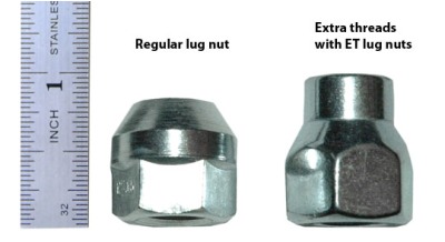

thanks the kid, i just read so much about vibration when running stud centric. Right now the washer style are my only option to get me to work. i get about 6 full revolutions of thread with the lug nuts right now and havent noticed them loosen. It is only temporary. I have 285's and very slight positive camber and i rub against my UCA significantly without spacers. maybe because i am running 16x7 rims so there is more tire bulge? Im going to get in a nice old fashioned piss up with the manager at NSOR saturday and see if they will swap these for the spidertrax hub centric and ill pay the difference. I found these e/t nuts from all pro but am i hoping a local store will have something similar because i cant afford any more time waiting for parts :(
https://www.allprooffroad.com/store/index.php?app=ecom&ns=prodshow&ref=6805A-AP
