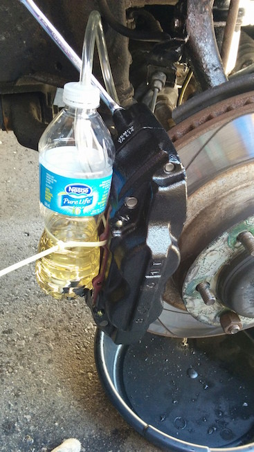

Yep, try to find a pal, even a dog might be better than doing it yourself! here was my setup the other day (see pic). I had the wife inside the truck pressing the pedal in the slow/full method....
0. Uncap master cylinder and top up Dot fluid.
1. Open bleeder.
2. Tell wife to press pedal to the floor and hold.
3. Close bleeder.
4. Tell her to release.
6. Go back to step 1 and repeat until there are no more large or tiny bubbles coming out the bleeder. Be sure to check the master cylinder and make sure it does not go low.
