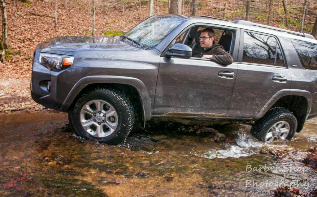

I was able to get out this past Friday(12/26/14) on the Tennessee Dirt Devil and check out about a 40 mile section of it. Took probably 2 hours to cover that 40 miles with lots of stops for pics! My buddy tagged along in his 2WD F150 that gets stuck in just about anything and he had no problems with any of it. I never really needed to take my 5th Gen out of 2WD but did for some stuff that I made harder on purpose. It turned out to be mostly hard packed dirt roads, that dried out well even after all of the rain we have had, and also included a ton of creek crossings. I'd love to go check out more of the roads and see what they are like, but I already have a few favorites.
Here are a few pictures and a link to the album with the rest. I edited a few of the pictures but a lot of them I did not and only cropped them. Not the best pictures of my T4R because I had to give control of the camera over to my buddy but hey what can ya do.

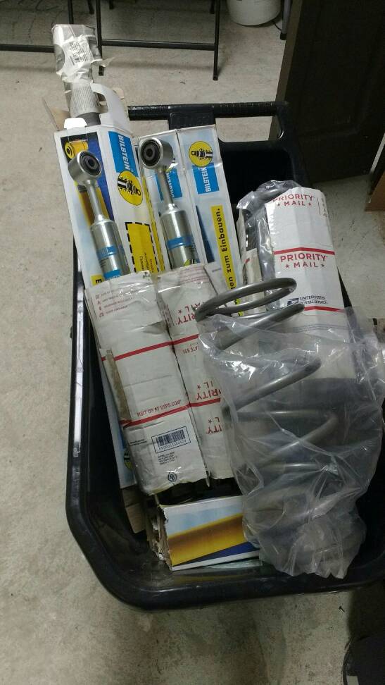

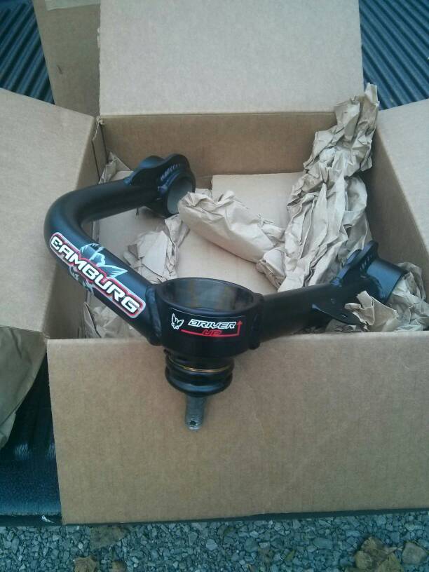

First of the lift parts started arriving tonight! I'm getting excited. Also received shipping confirmation on my Sonoran Steel lift and it should be in on next Tuesday. Looking like it might be Halloween day lift install!

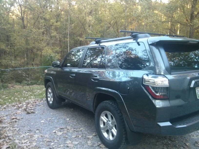

Thule Crossroads foot pack also came in this evening. Fitted them onto my old 65" square bars and did a test fit on the car. They won't ride around permanently on the car. Probably only when we use the RTT. Roof top tent should be in next Monday and already have a trip planned for it the weekend after Halloween.

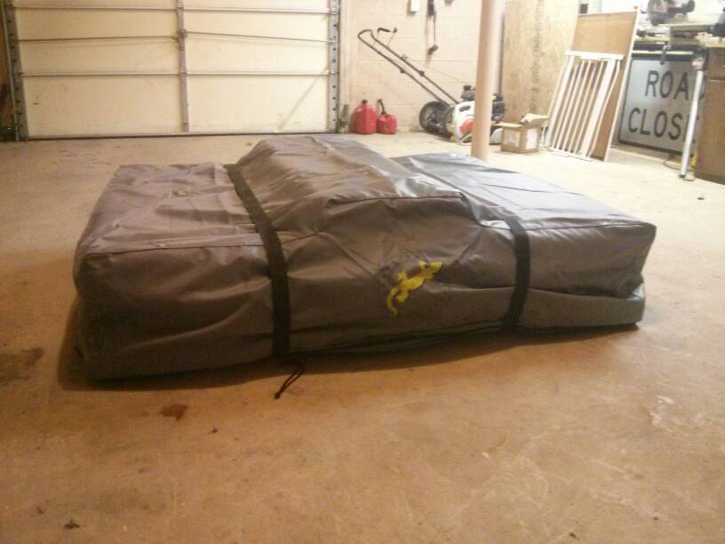

Went and picked up my roof top tent this evening. Got it put together and set up in the garage. Test fit on the 4Runner will probably have to wait till Sunday.

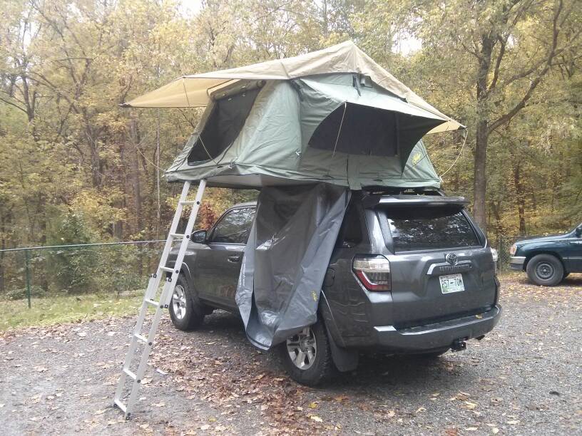

Got the RTT up on the roof of Riley today for a test fit with the help of a buddy. Looks like I am going to be designing a hoist system under my deck to make mounting and removing a one man job. Hopefully testing out the RTT overnight tonight.
Looks good, how'd she sleep?
Slept GREAT!. Usually I hammock camp when backpacking because it is so much more comfortable. But the 3" foam mattress in this RTT was very comfy. it seemed to breath well too even though it was super humid and a little rainy overnight. Cant wait to use it more. Slept just like a bed.

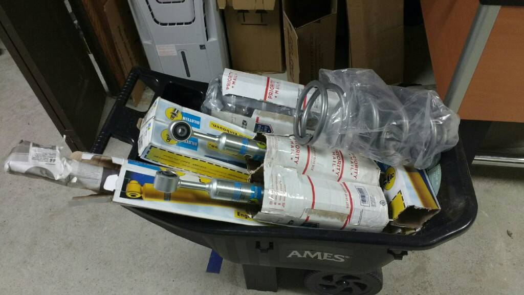

Sonoran Steel 5th gen lift parts came in this evening. Sadly had to travel out of town this week for work so all I have to drool over are these pictures I had my wife send me. Looks like I will be installing them this Saturday, Halloween day, right after I take her in for her 10,000mi service appointment.

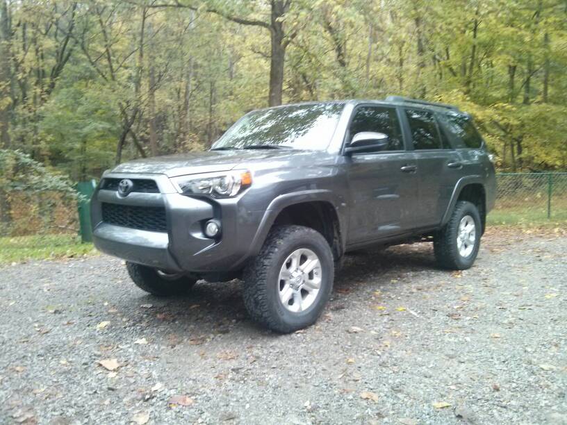

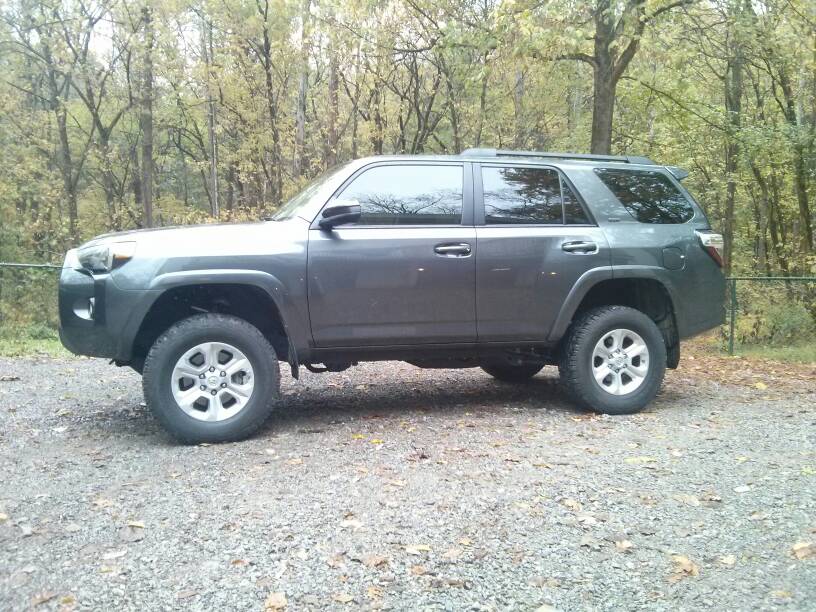

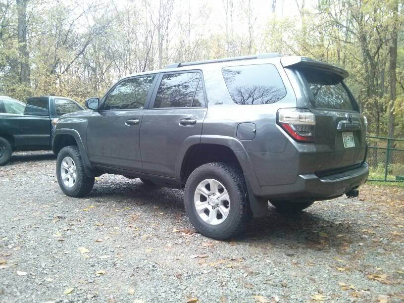

Spent almost all of Saturday installing my Sonoran Steel lift and Camburg UCAs. First though I had to take Riley in early for her 10,000mi service. Then I finally got back home around 10am and started on the lift. Finished installing the fronts around 3pm and then took a break for lunch. After lunch I attacked the rears and the replacement adjustable panhard bar. Finally finishing up around 6pm.
STOCK Measurements Floor to Fender
Front Driver 34 1/4"
Front Passenger 34 7/8"
Rear Driver 36 1/2"
Rear Passenger 36 1/4"
LIFTED Measurements Floor to Fender
Front Driver 37 3/8"
Front Passenger 38"
Rear Driver 38 3/8"
Rear Passenger 38 1/8"
OVERALL LIFT
FRONT= 3 1/8"
REAR= 1 7/8"
Kept some of the factory rake which is exactly what I wanted.
