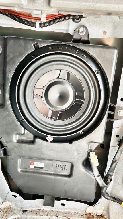

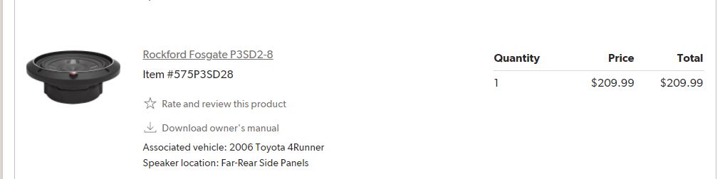

So I went to a local audio shop, which had hundreds of great reviews and was recommend by a friend.
The shop said my subs keep blowing because I have an after market unit pushing too much power to it and the subs keep heating. They said I couldn't just replace the existing one and would need to get an aftermarket sub enclosure + amp. Their quote for sub with new enclosure, amp, and new speakers = $2500 ($650 was labor). I thanked them and left. Their explanation just didn't sit well with me because I know I've seen tons of members on here swap out the oem sub with a aftermarket sub.
Ordered me a new sub from crutchfield for $210 (pandemic pricing) that fits right into the oem enclosure. No cutting was required and only modification was having to drill new holes as they didn't line up for the new sub.
Used the following two videos for instructions: First video is great for overall instructions to get to the sub. Second video is good for wiring part.
2003 - 2009 Toyota 4Runner OEM Subwoofer Install / Replacement - YouTube
4th Gen Toyota 4Runner JBL subwoofer replacement- the easy way. - YouTube
Aftermarket radio pushing too much power? . Good on you for walking out.
