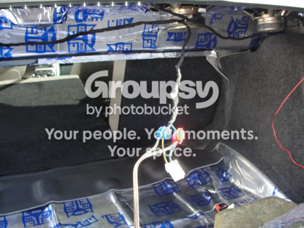

Me and my dad installed two 12 subs with a mono d amp to stock headunit. in his Chrysler 300c. Pretty much you need tap into both rear speakers and connect it to a little RCA box. The rca will have outputs for the amp. And after that you just get power source for the amp. Car battery is the best source. If u want pics message me
Tap into the rear speakers like that.
Then connect the amp to a converter. And the wires from the speakers also go into the converter. Then like I said connect amp to car battery
