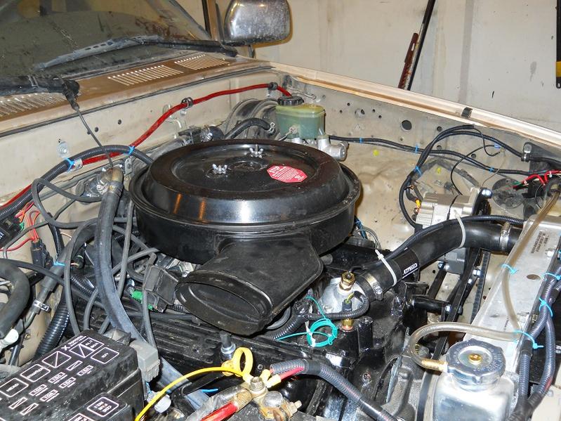

So you like Chevy muscle? You could always do this...

thats bad ass...but a little more than i need in this old whore lol. as much as i love chevys im starting to think i may just need to put the 3.4 in. am i right in understanding i can use my old tranny and t case? i know i know....theres plenty of info on the web......:whipping2
