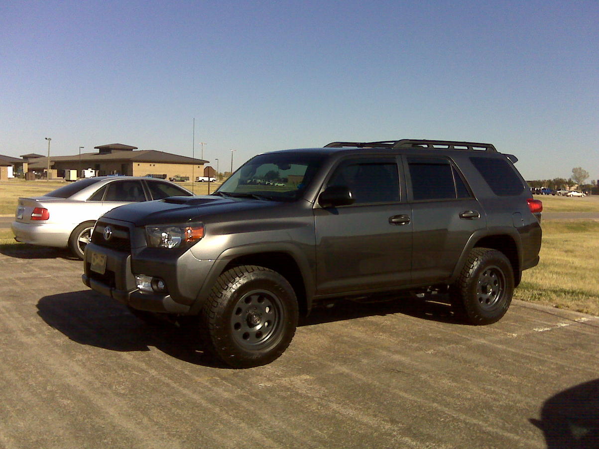

do you have some photos? i was thinking about the bilstein 5100 set to 1.75 inches but maybe that is to much
I got about 1 3/4 of lift with the topout spacer on mine before I went ahead and lifted the whole thing. Here is a pic when it was leveled. But if you even think you might want to lift just do the lift to begin with I got new rims and tires and leveled it and about 2 months later decided to go all the way and had to have the struts pulled apart again costing me another 200. 1st pic is leveled with stock rims and tires second pic is leveled with new rims and tires 265/70/17 terra grapplers
that looks good to me. What spacers did you use?
the bilstein 5100 set to 1.75 are suppose to yield 2"...
Remember if you buy a spacer say like a 1/2" spacer it will give you 1" of lift or a 3/4" spacer will give you 1 1/2" of lift. Topout spacers always double the lift. I would go with a 3/4" on mine . Just my personal opinion.

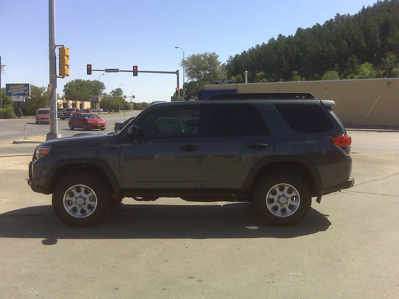

Here is my 2011 Trail KDSS with the top plate spacers and the stock 265/70/17 tire size. If you look at the spacing between the top of the fender and the tire, you can see that the front tire is a tiny bit closer to the fender than the back tire. However, if you look at the lower body lines and the frame compared to the ground, they are pretty level. Whichever leveling method you prefer is up to you, but I prefer the frame to be level rather than using the fender bodywork as the indicator. (Granted, it's a bit hard to tell from the photo.)
What size of spacer did you use and how much lift did it yield you ?????
Looks nice !
The Toytec top plate spacers are 1/2". I haven't measured the before-and-after heights, though. I was only interested in visually leveling out the front, and the spacers accomplished it for me (as seen in the photo I posted). :)
