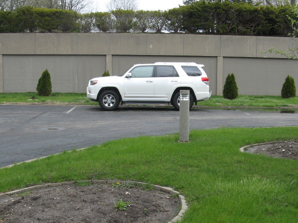

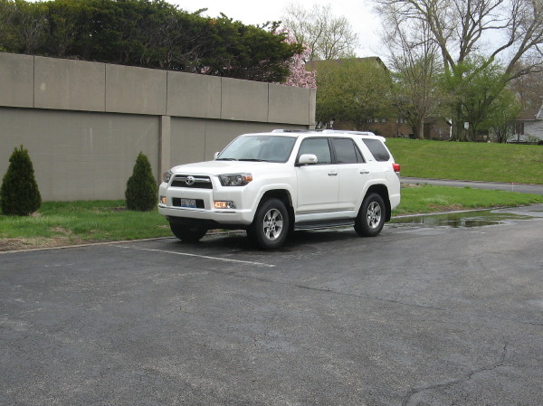

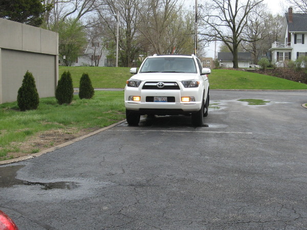

.Here ya go.. the driveway slopes just a little from R to L.

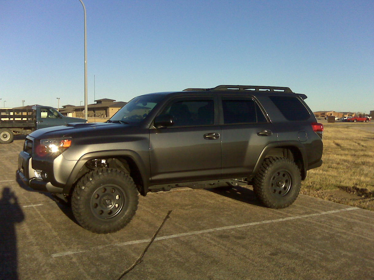

I got about 1 3/4 of lift with the topout spacer on mine before I went ahead and lifted the whole thing. Here is a pic when it was leveled. But if you even think you might want to lift just do the lift to begin with I got new rims and tires and leveled it and about 2 months later decided to go all the way and had to have the struts pulled apart again costing me another 200. 1st pic is leveled with stock rims and tires second pic is leveled with new rims and tires 265/70/17 terra grapplers

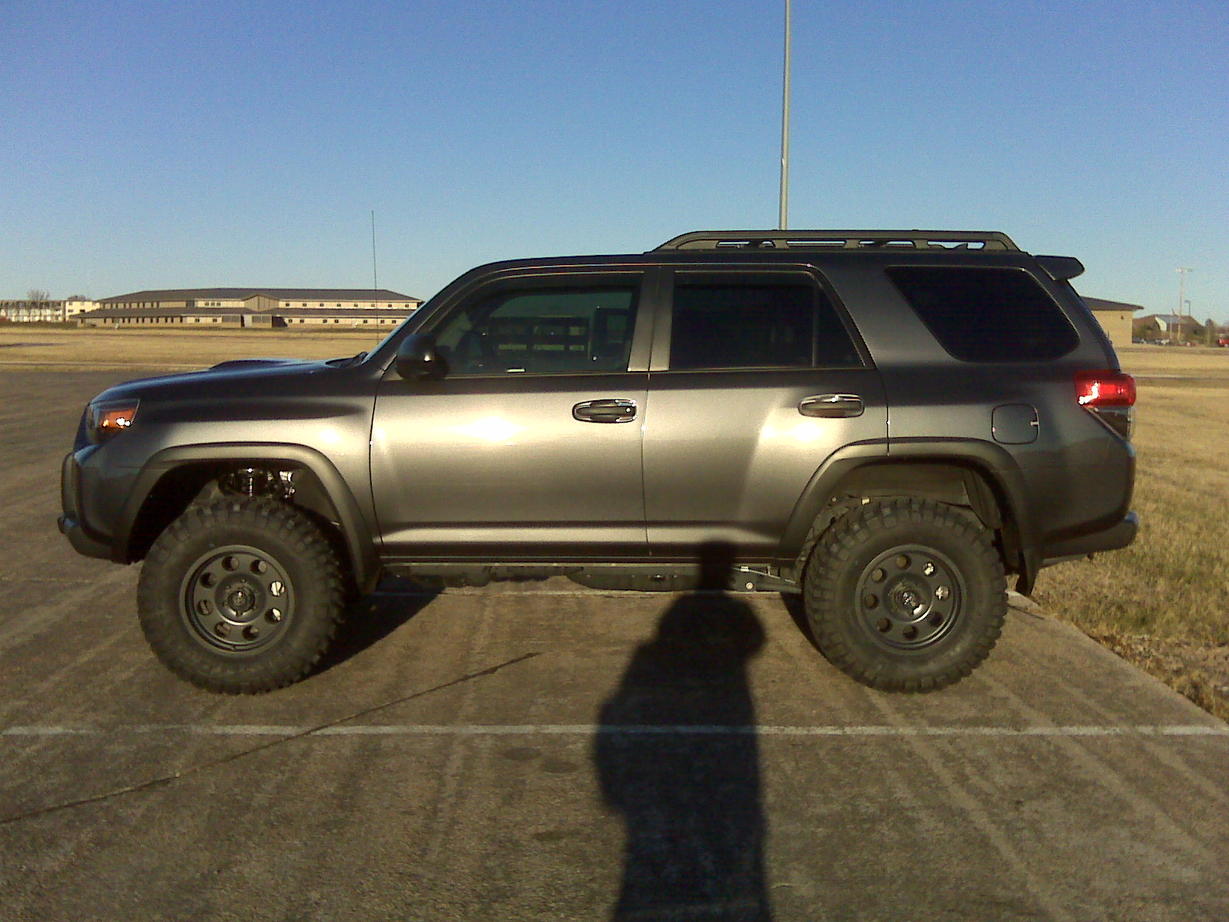

Thanks the second picture is the leveling kit with 265's I lifted it about 2 months after that pic was taken and it looks like this now and for number sake it now sits
FR 39.2
FL 39.1
BR 39.4
BL 39.5
Also these pics don't have my sliders or bike racks in the pics they are old pics
FR 39.2
FL 39.1
BR 39.4
BL 39.5
