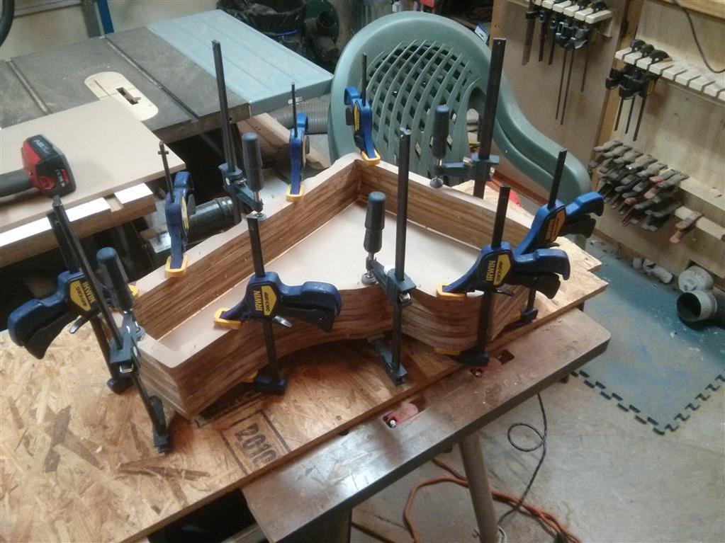

Just a few progress pics. Removed the original JBL sub and amp to make room for the new enclosure. This will house a JL 10TW3.

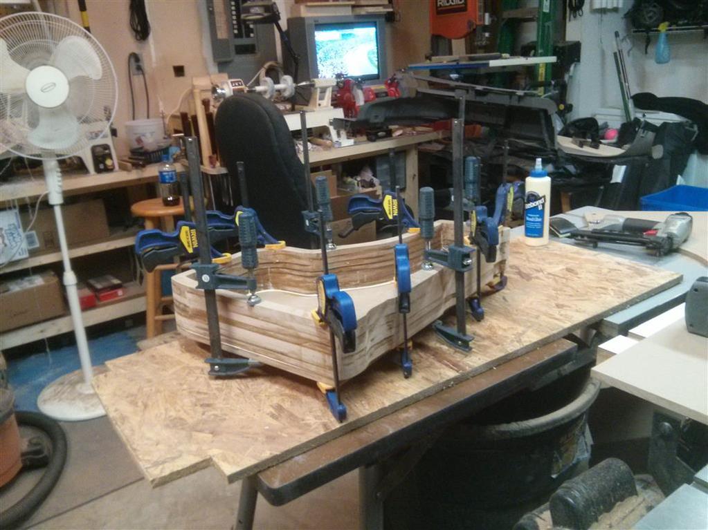

Traced out a cardboard template and cut until it fit the way I wanted. Then cut "rings" of 1/2" MDF and sandwiched them together to get an internal depth of right at 4". Just need to make the baffle for the front and get it mounted.

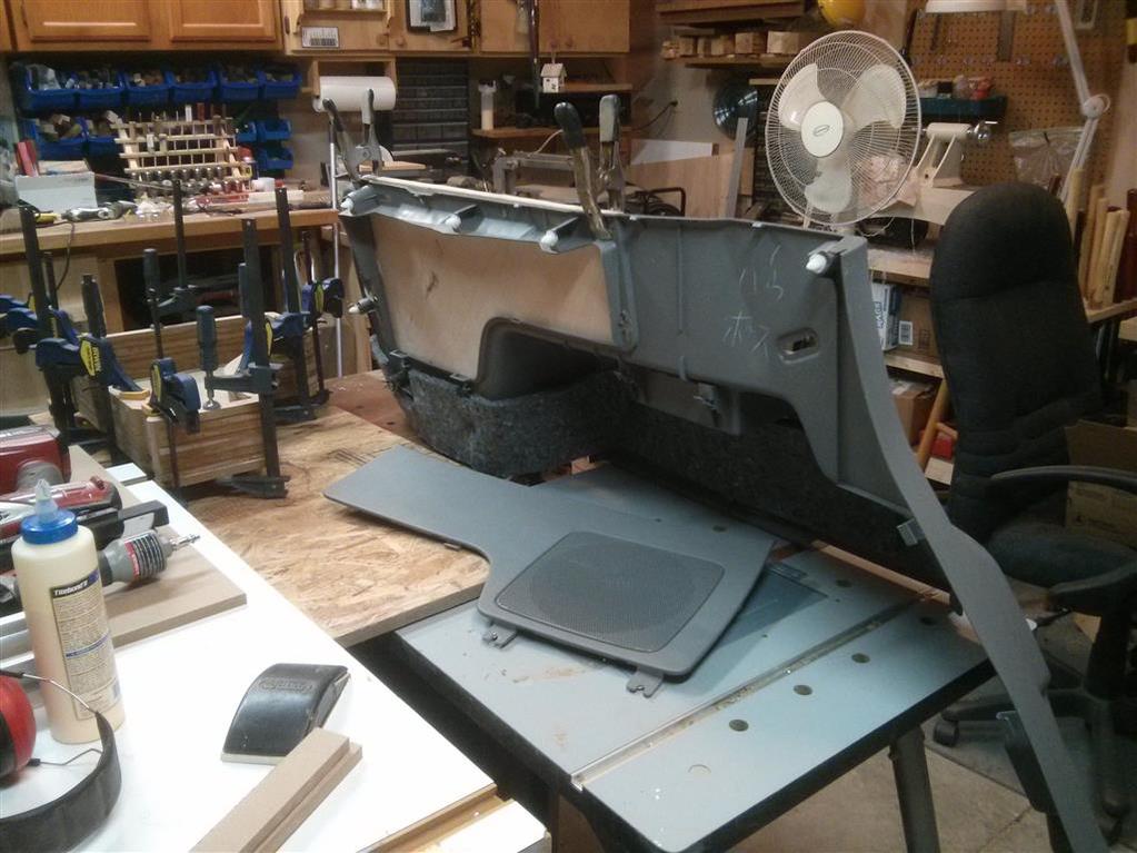

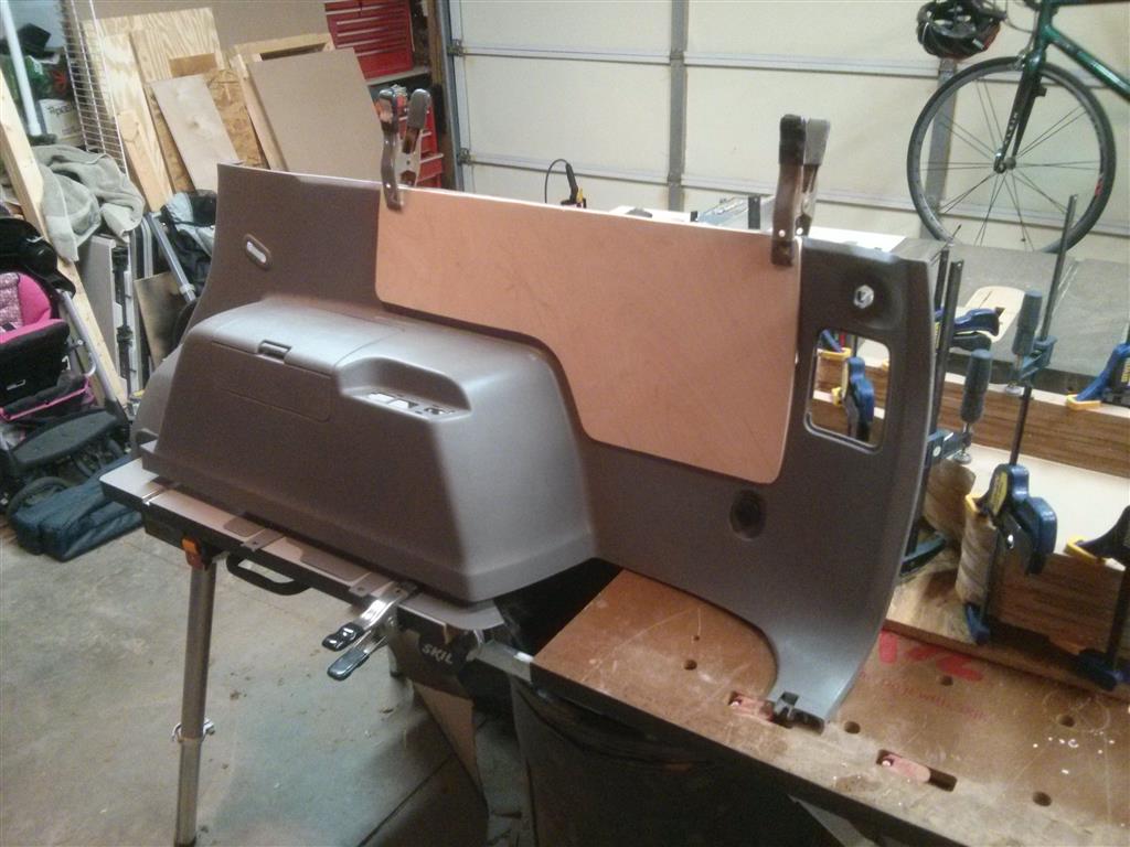

The original grill was removed by grinding down the plastic welds. I'm intending to keep the original panel in good enough shape to put it back to stock some day if I need to. The panel clamped up in the picture is the beginning of the new grill that will also be extended over the wheel well to mount the amp.

Strength and rigidity are actually the reason for doing it. Sound quality suffers with a thin walled enclosure. When it comes to subwoofer enclosures, heavy and rigid are the main keys along with the obvious enclosure size and design. Since this is a sealed enclosure, all I had to do was hit a target air space and with the sub I'm using that's anywhere from .5 to .8 ideal. This should be somewhere in the .6 range less displacement of the driver. It'll give up a little bit of low end extension but that's alright for my needs to get it into the space.

I personally don't consider it overkill. It's really not much more than 3/4" in wall thickness. Maybe a touch more because I cut the original template a bit proud of my original scribe line. It's no different than using 3/4" flat stock on a square box, but in this case I stacked layers to conform to the irregular shape.
As for sealing the enclosure, I haven't had to add extra sealant to a box I've built in 20+ years now. If your joints are true and you glue and clamp properly, you don't have air leaks.

To directly answer this, if I had gone the fiberglass route, polyester resins will generally not bond to plastics. So I would have had to use the original enclosure as a plug to create a mold and then create a new enclosure out of that mold. Trying to get anything to permanently bond to the interior of the stock enclosure is just a failure waiting to happen. No matter how much you scuff up the plastic it will delaminate over time if you get it to stick initially at all.
Some will say epoxy resins bond to plastic, but as I noted in the post above above, if I have an alternative to fiberglassing I'll take it.

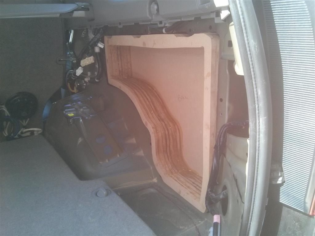

Haven't made much progress other than to test fit the enclosure. I should be able to work on the front baffle tonight to button up the enclosure portion then on to the grill/trim panel work.
I'm expecting to need to fine tune the fit with a grinder to get all of the stock panel clips to reach where they need but I can't do that until I get the baffle on and set the final depth and secured in place.
I didn't really bother cleaning up the interior either. Once I seal it up and stuff it with polyfill it'll never been seen again :)

Progress has slowed to non-existant at this point. Had a family vacation along with building a new shop at the house that have put the 4Runner mods on hold for a bit.
I have it installed and functional, but looks like crap until I can start working up the trim work the way I want. I think I'll end up breaking out the fiberglass for this one as I couldn't get any flat panel trim to look right when I left off and I want to relocate the amp over that wheel well so I'll integrate it all into the trim work.

Unfortunately it's not a drop in solution that I could make and sell. I ended up having to cut up the factory panel to clearance the front of the sub once the final baffle was in place. I will be reworking the entire panel to integrate the sub grill and amp rack.
