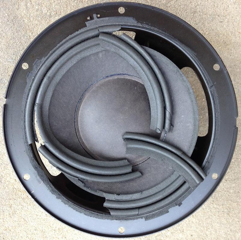

Hopefully this will be a help for any with a subwoofer problem. My 2004 4Runner, Limited, has a JBL sound system. The subwoofer started to make a rattling noise. I had to turn the bass all the way down to limit the irritation coming from it.

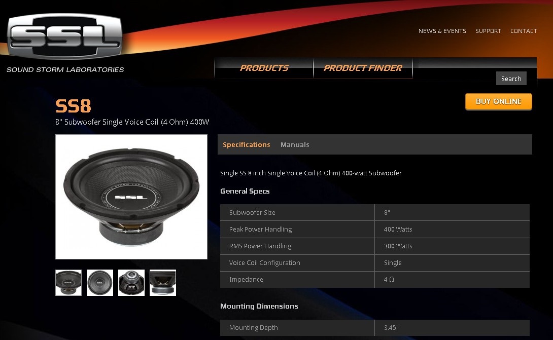

I went in & "Juan" showed me the replacement spkr, a Sound Storm Lab SS8, 400W unit. The spkr & his work carry a 1 yr. warranty so I said do it. While I waited, I was "treated" to a number of vehicles being tested to make sure the bass sound would vibrate everything around including the glass in the windows in the waiting area. How one doesn't go deaf with a system like that is beyond me.

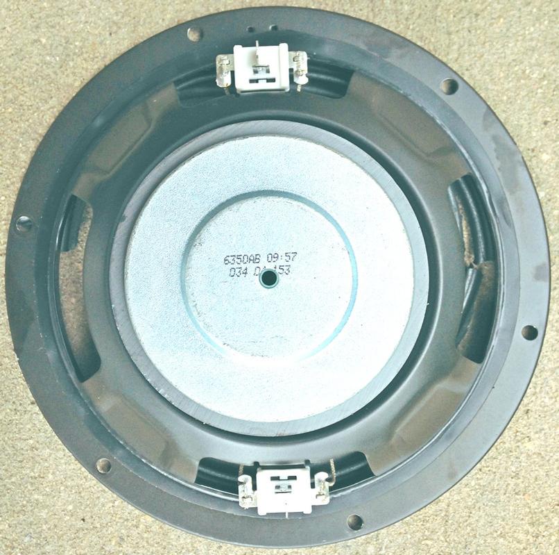

However, I am including pics of the original spkr and the new spkr on the website where the SSL can be bought if someone wants to do it themselves. SS8 - Sound Storm Lab is the site where that spkr can be found.
I put the numbers off the factory spkr into Google w/o finding anything.
The 2004 4Runner stock JBL Subwoofer is 8 & 7/8" Diam, with 6 holes. Cone is 7 & 1/4" Diam. & Depth is 3.45", & 4 ohms.
