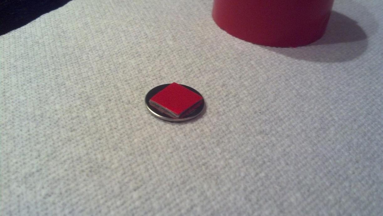

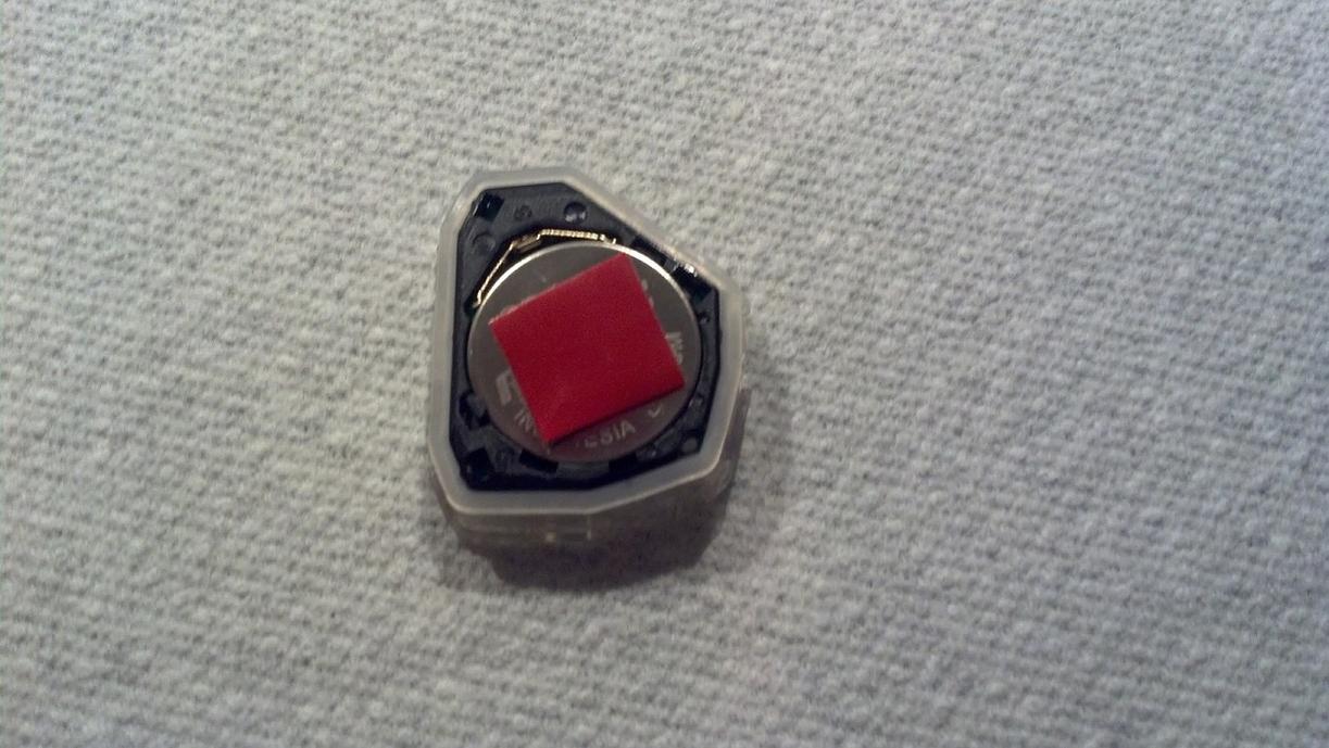

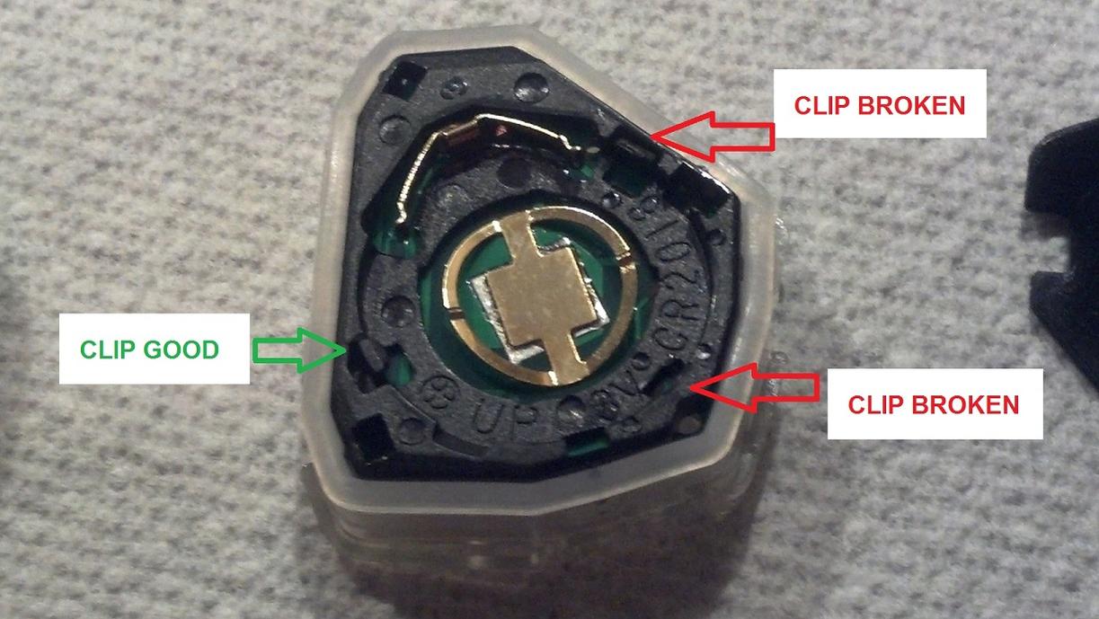

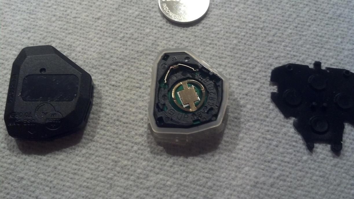

I was having the same problems as others here. Bought two keys from ebay seller extra_partss, got them cut and programmed just fine. They both worked fine for about a week before the first one took a crap and the keyless buttons wouldn't work. I pulled it apart and re-seated the battery (it seemed loose to me), and it worked fine for another few days before taking a crap again. The second keyfob took a crap on me about 2 weeks later. I thought they were just bad products and was about to contact the seller and ask for a refund.
But before I did that, I wanted to try one last time to get them to work. When I took the keyfobs apart, no amount of re-seating the batteries would make the buttons work or the red LED light up. This made me think that perhaps the batteries were both dead, so I went to the store and bought two new batteries (I guess its possible that these are old stock of keyfobs, so the batteries are no longer good). Installing a new battery in the second keyfob made it work again perfectly. When I went to install a new battery in the first keyfob, I realized why it seemed so loose -- two of the three clips holding the battery in place were broken, so it wasn't holding the battery securely in place (see pictures with arrows). I decided to add a thin layer of some 3M foam adhesive tape I had lying around to the back of the battery, so that it would compress the battery against the contacts when I snapped the other cover in place. After doing that, the keyfob works again. Hopefully this will solve the problem for good.

BTW, my problem is identical to what Gixxersteve posted: Two of the three plastic clips that hold the cover shut are broken.
