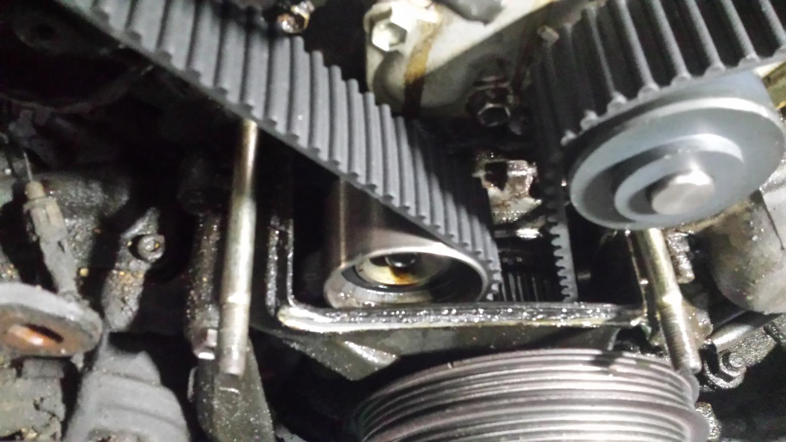

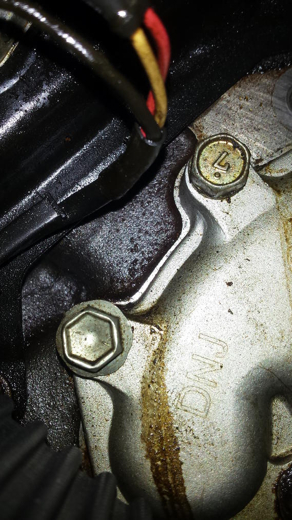

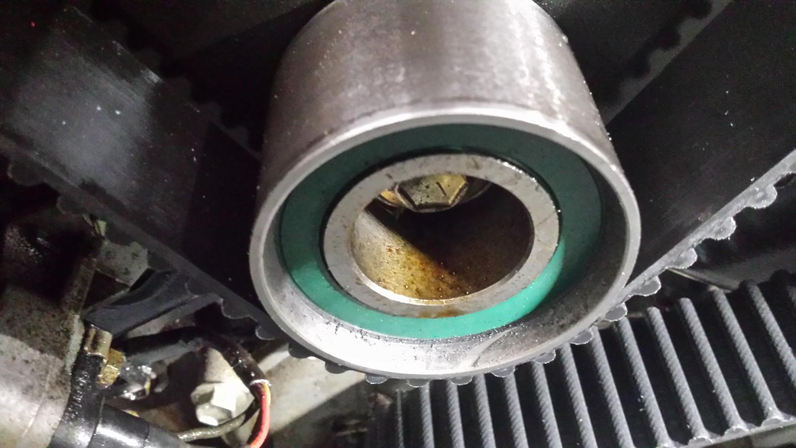

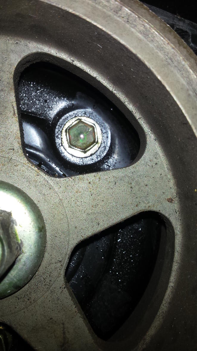

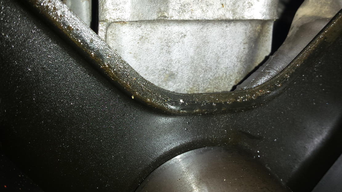

I took the TB cover off and saw an oil film. Removed fan assy and hub and it was oil soaked all over. I'm posting some pics to see if anyone can help me pinpoint the leak. It's wet at the top of the backing plate behind the cam sprockets and oil in the center bearing. 20180309_144733.jpg
How could I lose 5 qts of oil in 110 miles one way and only 1/2 qt coming back? Could the front main be slinging oil up or do you think the cam seals are leaking down?
On another note, I reached down to see if my socket was going to fit on the crankshaft bolt and I loosened it by hand.

You may as well tear down the front of your engine to get a good look at your camshaft seals and crankshaft seal. The oil is coming from one of those seals. With the laws of gravity in mind, it sounds like one of the cam seals had a catastrophic failure. But then again, if oil leaks out of the crankshaft seal, onto the timing gear and then onto the timing belt, that oil would get slung all over the place.
The fact that your crank bolt was on hand tight is not good. Whoever worked on it last did not torque it to spec. Maybe with the crankshaft pulley (aka Harmonic Balancer) being a little loose, it made the crankshaft run a little out of balance and put stress on the crankshaft seal.

I replaced the pcv last year. I wonder why the timing belt is not wet or oily.

Got her torn down, cam seals dry but the crank shaft seal was blown out about 3/16 from where it should have been seated and sitting at a slight angle. Now the question is what caused it. Would an extra 1/2 qt of oil do it? Unless my dipstick is wrong I always have to put in 7 qts to bring it to the full mark. Also I was able to push the new crank seal almost all the way in with my fingers and just a couple taps. Seems like it should be tighter.
