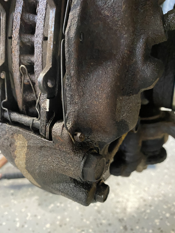

Friends- changing front pads and rotors only. On my rusty trusty 4Runner I can loosen all bolts, but can’t drive out the two pins. Any suggestion?
I have used hammer, heat, PB blaster.

Here are some pics.. Do I pound out from the back? Or try and grab with vice grips and pull out from the front? There are numerous videos on youtube changing front pads, and the pin always comes out so eas!
The round side in first Pic is the out, second Pic is the hitting side
They come out so easy because those videos aren't from NH! I absolutely lather mine in anti-seize before I put them in. Step 1 - get new pins. Step 2 - soak them in a good penetrating oil. Step 3 - get a punch about the same size as the pin. Get your hammer and pound those suckers out.

Have you tried grabbing the pin with some needle nose (locking if possible) and twisting it back n forth? The twisting motion should help break the rust away.
It doesn't look like you attempted to hit the opposite side with the head. If you tap it in, it will often loosen the pin. If you hit the opposite side of the pin too hard it will flare out and there will be no hope for removing it without cutting it. Like the previous post said also, try to grab it and twist it to loosen it. I make it a habit to grease the pins every rotation. They often seize and trash the brake pads.
These can be a real PITA. I’ve had to cut them when I lived up north, grind off the tips, and drill out the holes. I’m out of the salt belt now and I still grease them before assembly.
I made a set at one point out of stainless rod with stainless pins through the ends. My taco ran those for years without issue. Good approach if you can’t find the pins…they are just guides really.

For me, it was lube with lightweight oil, tap toward the front (with a brass hammer if you have one), lube, tap toward the back, and on and on. Use moderate taps, don't try to crush it all at once. Have to be patient. Even if no movement can be discerned at first, there is movement, and the oil will get in there. Every 20 hits or so, try twisting the head of the pin with good serrated-jaw pliers. When it gets to where you can turn the pin, keep applying oil and twist and pull and tap back and forth. I know a lot of folks use PB Blaster, but in my experience, lightweight oil or WD40 work better. Patience is your friend, though, so don't be in a hurry. You'll get it!
