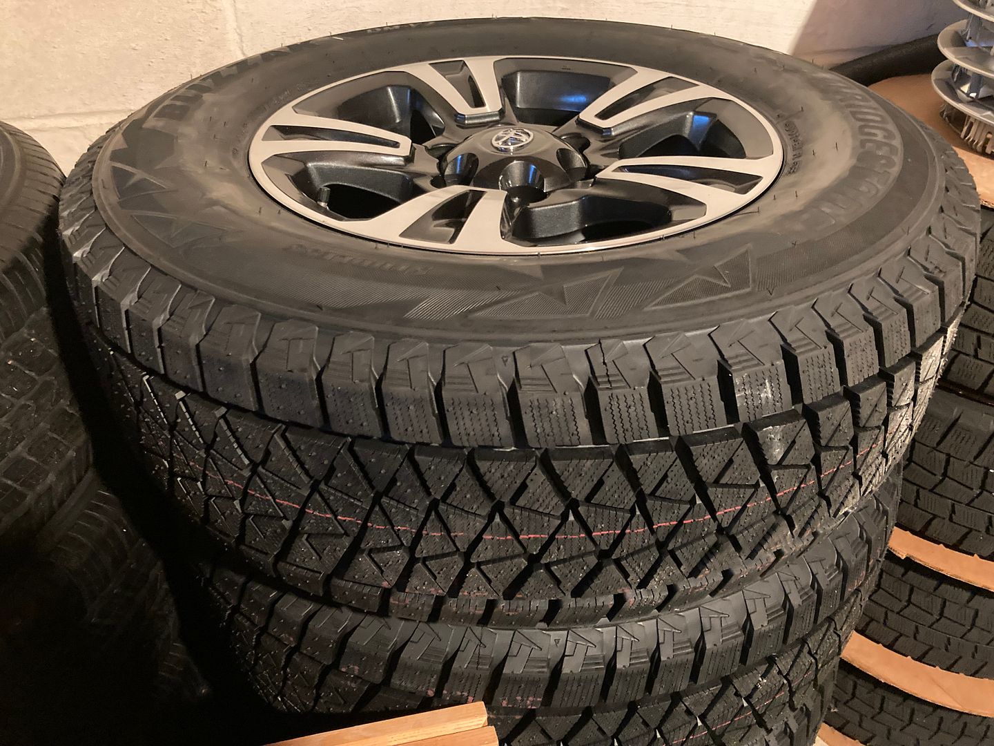

If you really want the absolute best traction in snow and ice driving, you really have to go with a dedicated ice and snow tire - one with a snowflake on the sidewall. Trust me, I live where we average 100" of snow each winter and I've tried just about everything. What do I run on my T4R? Blizzaks.

Those are nice looking tires. I guess I should have given a little more information in my OP. I drive a 2016 Silverado 2wd work truck daily with all season cooper tires. That thing stops on a dime on the ice and has great traction. But when I get home and jump in the 4runner it's like a golf cart on the ice. I don't think I'd put those tires on my 4runner, but I just don't understand the huge difference in traction and stopping power.

Another tire related thing that may be causing the difference you see between your work truck and T4R could be tire width. Many people think wider is better on ice. Actually, the exact opposite is true. You want to maximize the number of pounds of downforce per square inch of tire contact area on ice. (Just look at a World Rally Car set up for ice.) Those Blizzaks I shared are actually narrower than the stock 265's too. Are the Chevy tires narrower?
Another vote for the Bridgestone Blizzak's, great tire for snow and ice. Pick up a second set of rims too and run the Blizzaks during the winter.
Yes the tires on the work truck are much narrower. Don't get me wrong, the chevy is still a challenge on ice and I have to be careful but the 4R is horrible. I have the winter rated tires on the 4R with the little mountain but they are wide and the tread looks like it's more for off road.
I think I will do that. The Matte black OEM rims are on sale at 172.00 right now, I'll have to see who has stock. I defiantly need to do something; Indiana is getting more and more of the wet/freezing weather that results in icy roads.
