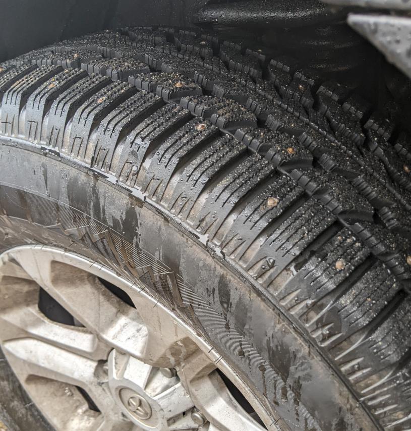

This winter I put Nokian LT3 studded tires on the oem wheels and have been using them. I would say in snow/slush performance is about 20% better than k02's. On ice probably 30% better and much more predictable. The studs are not super aggressive and there are not a ton of them, so driving on bare(but cold) pavement does not suffer. Much more planted and predictable for winter driving. I can still break traction in sharp turns but it is much more controllable.
I see other people with normal tires or MT's slipping and sliding around or not stable and it feels like normal driving for me with the snow tires. k02's were good but there is a definite difference mostly on ice or with stopping distances.
Yes, I'm surprised this one is still going as well. It's very difficult, if not impossible to beat a set of dedicated winter tires with studs for snow and ice driving. That being said, even they don't work GREAT on ice. You still need to be very careful, but you'll be FAR ahead of anyone without them.
