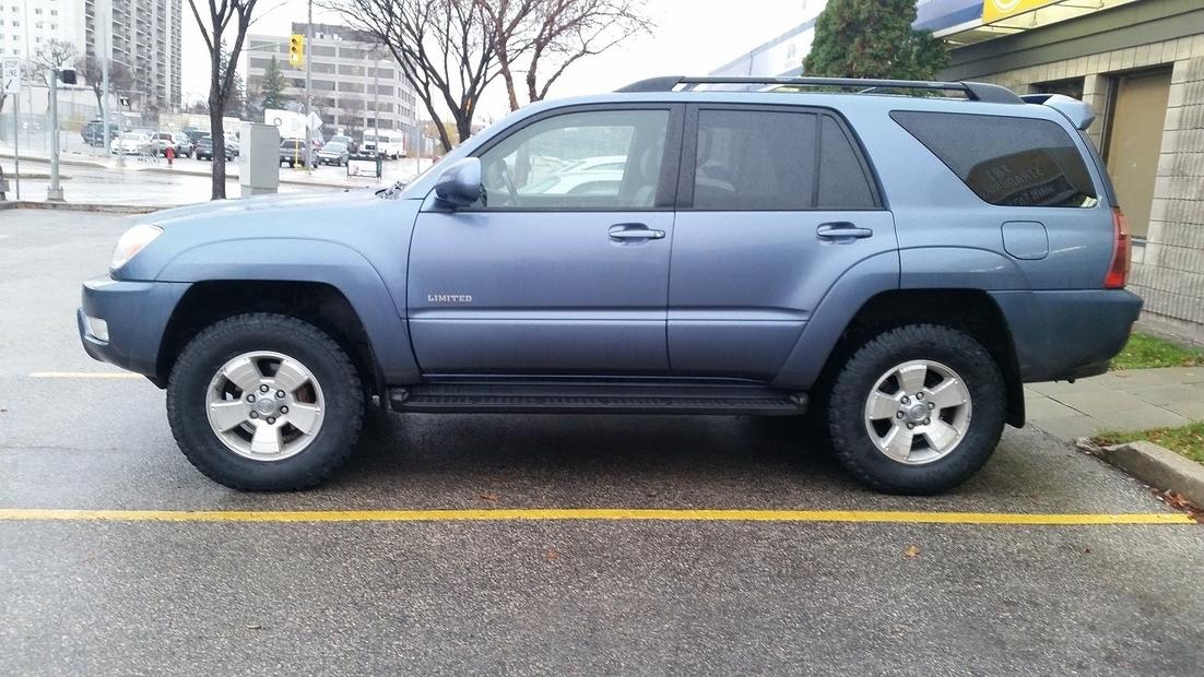

Here is mine, FJ coils front and rear, Bilstein 5100's front set at .85
General Grabber AT/2 265/70/17
Love the ride and the look!

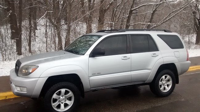

Finished result
Here it is...
Bilstein 5100s, front (set at .85) - ($167.90)
5100s rear - ($154)
1/4" Poly spacer ($7.50)
Front strut stem cushion and washer kit ($20)
KYB Rubber coil isolator set - front strut top plate ($20)
__All of the above purchased from Wheeler's Off Road
New OEM T4R coil springs, front and rear ($251 for the set - after $20 off coupon) OUCH!!!
__from partznet (Conicelli Toyota)
The driver's side lean is gone, it is 35.5" from the ground to the center of the wheel well on both front sides now. And 36.5" on passenger side rear, 36.25 on driver's side rear.
I like it. Rides like a new truck!!
